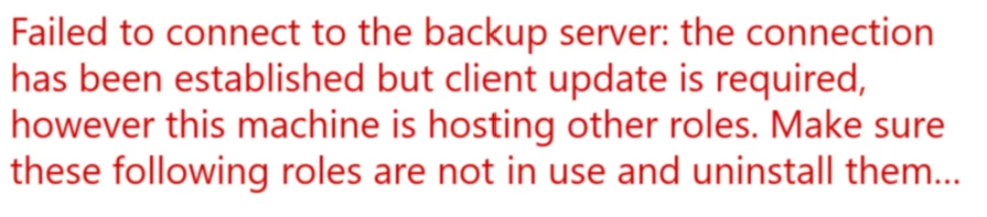

  • New Here
  • May 1, 2026
I’ve performed the registry edits above, but do not see an Update option when attempting to login, all I receive is this message:
