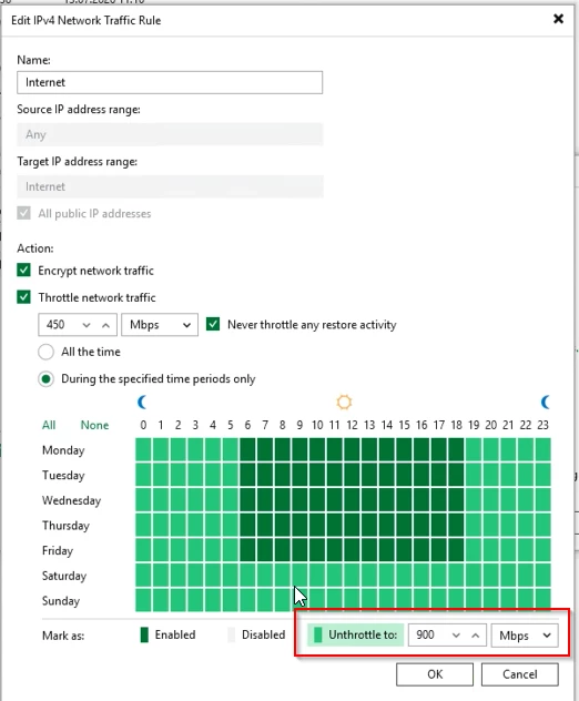

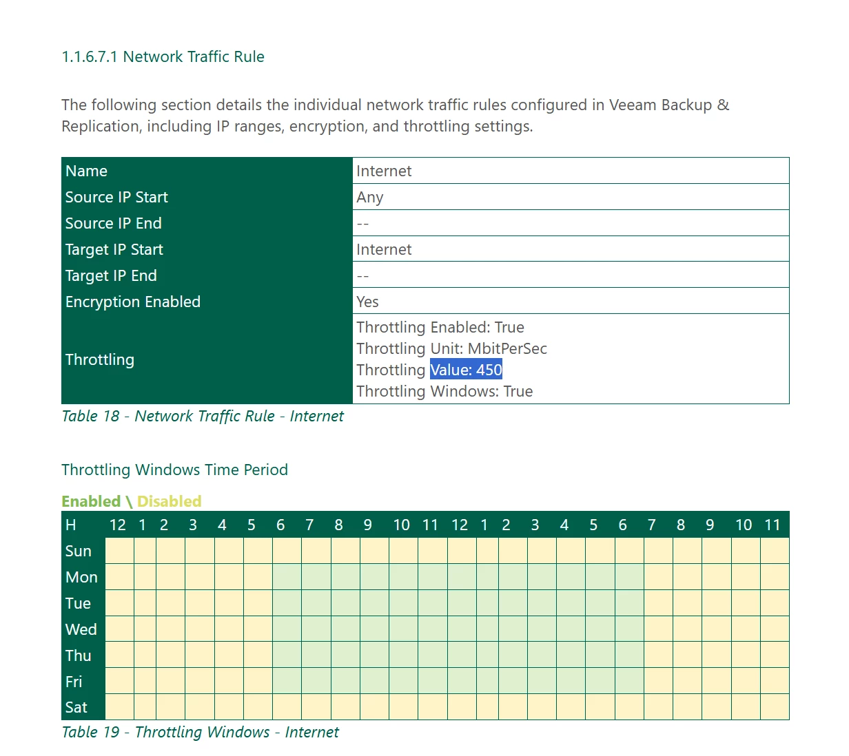

Hi ​@jcolonfzenpr, we just seen some missing details regards Throttling - the Option “Unthrottle to” is not recognized:
Maybe you could also integrate the “Unthrottle to” Option?
Thanks & Best, Markus

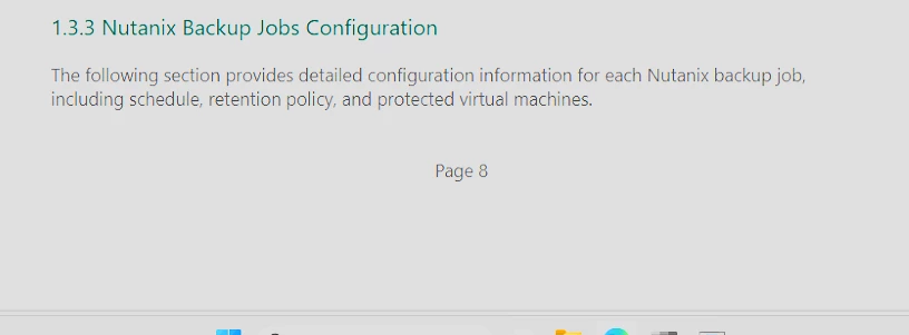

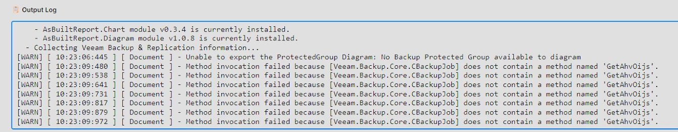

Dear ​@jcolonfzenpr, I just deployed AsBuiltReport (latest) on a Nutanix AHV Site.
There are some Infos missing, regards Job Configuration:
Log File attached, maybe you have an Info for us on this - I can also provide you more details.
Cheers, Markus
jcolonfzenpr
Cheers, Markus
Could you please provide the debug log for review? This will help me diagnose the issue more effectively.
https://github.com/AsBuiltReport/AsBuiltReport.Veeam.VBR#memo-log-collection
send it to: jcolonf@techmyth.blog
