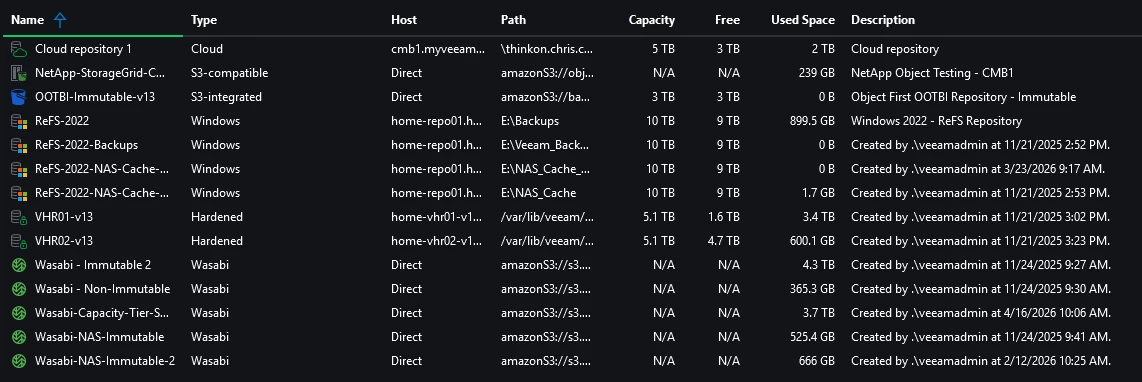

@jcolonfzenpr - not sure if possible but would be nice if you could input API information to get external S3 Object Storage sizing.  I have both Wasabi and NetApp StorageGrid which I test from my lab, as the NetApp is something we just implemented.
jcolonfzenpr
Could you check if the Backup Console displays usage information for the object storage repos?
I can't retrieve the information from PowerShell using my Wasabi S3 repository…

I'm pretty sure that worked in version 12
Any updates on this?
Chris.Childerhose
Forum|alt.badge.img+21
@jcolonfzenpr - I just checked the console and the Used Space populates but the Capacity & Free shows N/A for any Object storage repo.
jcolonfzenpr
I believe the usage is calculated based on the total size of all backup files stored in the repository, not from object storage API. Unless this is a bug...
