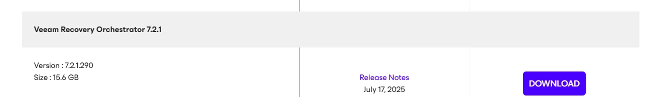

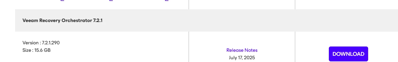

Is anyone able to assist here? I’m trying to upgrade to Veeam 13, as part of the overall upgrade I have to upgrade V Orc from my current version 7.1 to 7.2. However, all that I can see in the previous versions is:
But the pre-req explicitly says:
Upgrade to Orchestrator version 7.2.1 is supported from Orchestrator version 7.2 only; upgrade from Orchestrator versions 7.1, 7, 6, 5 and 4 to version 7.2.1 is not supported:
However, I’m unable to find the 7.2 version I need to upgrade to 7.2.1.

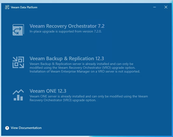

Unfortunately the only version of Orchestrator there is the following:
According to https://helpcenter.veeam.com/docs/vro/userguide/upgrading_vro.html?ver=13 I need 7.2 as I’m already on 7.1.
But thank you for sending it over!
LGH

Much appreciated, I’m going to try that version now. Possibly they’ve not updated their documentation but I’ll come back and let you know and then I’ll get in touch with support.

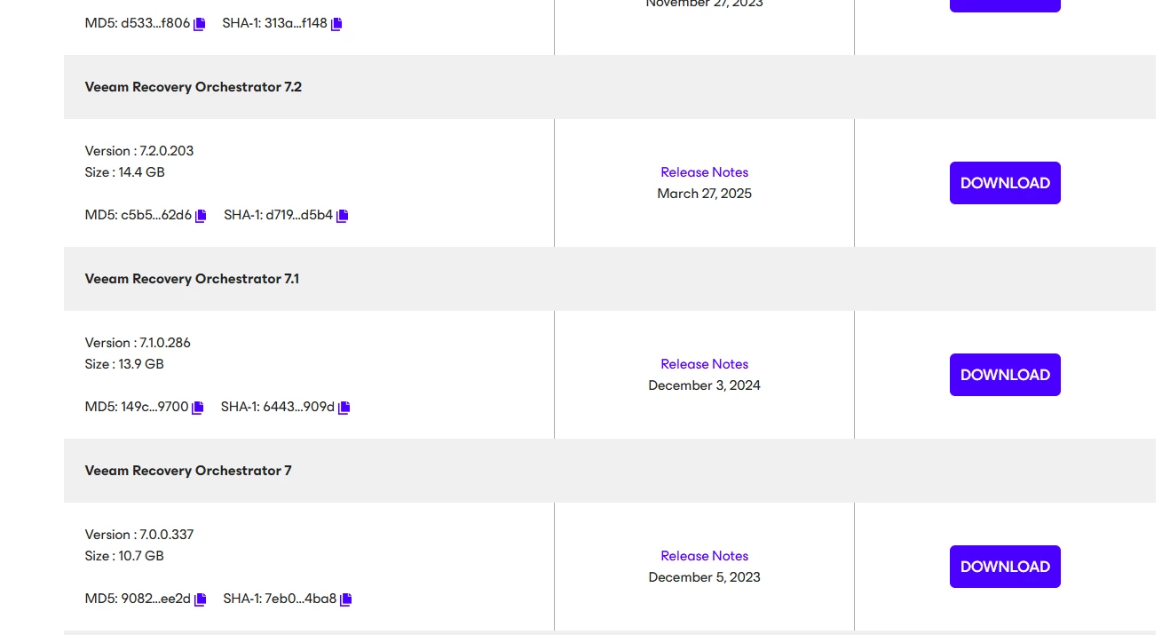

@Iams3le ​@coolsport00 ​@kciolek
Thank you for your help here, I had an idea…
I went to the Way Back Machine and pasted in the Veeam downloads page, from here I went back to 08/10/2025 and only found…
I could then get the download link which for anyone needing 7.2 is:
https://www.veeam.com/download_add_packs/availability-orchestrator/7.2
Veeam at it again with their documentation!
Thanks again all, hopefully this assists someone in the same boat.
