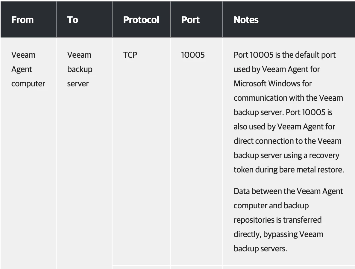

Looks like the default port is 10005:
TCP Port Used for Windows Agent to VBR
For other services (i.e. file restores and auth tokens), other ports are required as listed in the link.
