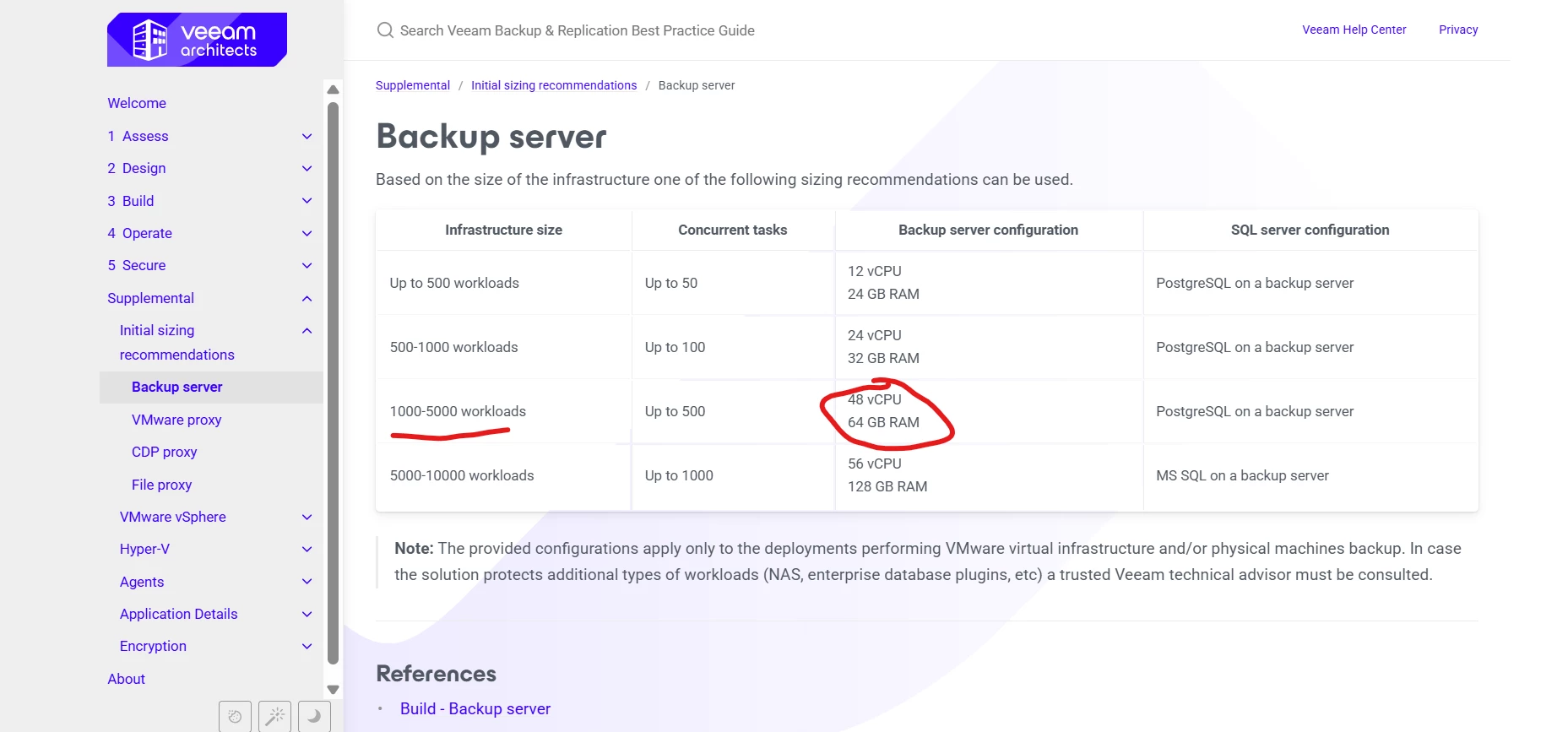

@vladensClaz After I gave my opinion above, I remembere teht ou can use the Veeam BP to make your decision better.
Look at what the BP says.
so, to have a 48vCPU VM you shold have at lease 48 core on your ESXi, but of course you need to have much more physical CPUs on your ESX to avoid co-stop situations.
Using the BP you can hav a starting point to decide between virtual or physical
https://bp.veeam.com/vbr/Support/configurations/backup_server.html
