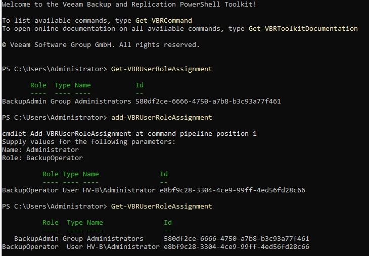

Jason Orchard-ingram micro
Forum|alt.badge.img+3
hi ​@NeonFrog
Testing my lab I’ve found that this cmd did work, but only when I used a “user name”, it didn’t work when I tried to add a local group (Windows group).  I haven’t yet tried on a domain joined pc. As i don’t have this setup in my lab.
Yes, the cmdlet adds both local and domain users, the issue seems to be that it can’t resolve local and domain groups.
