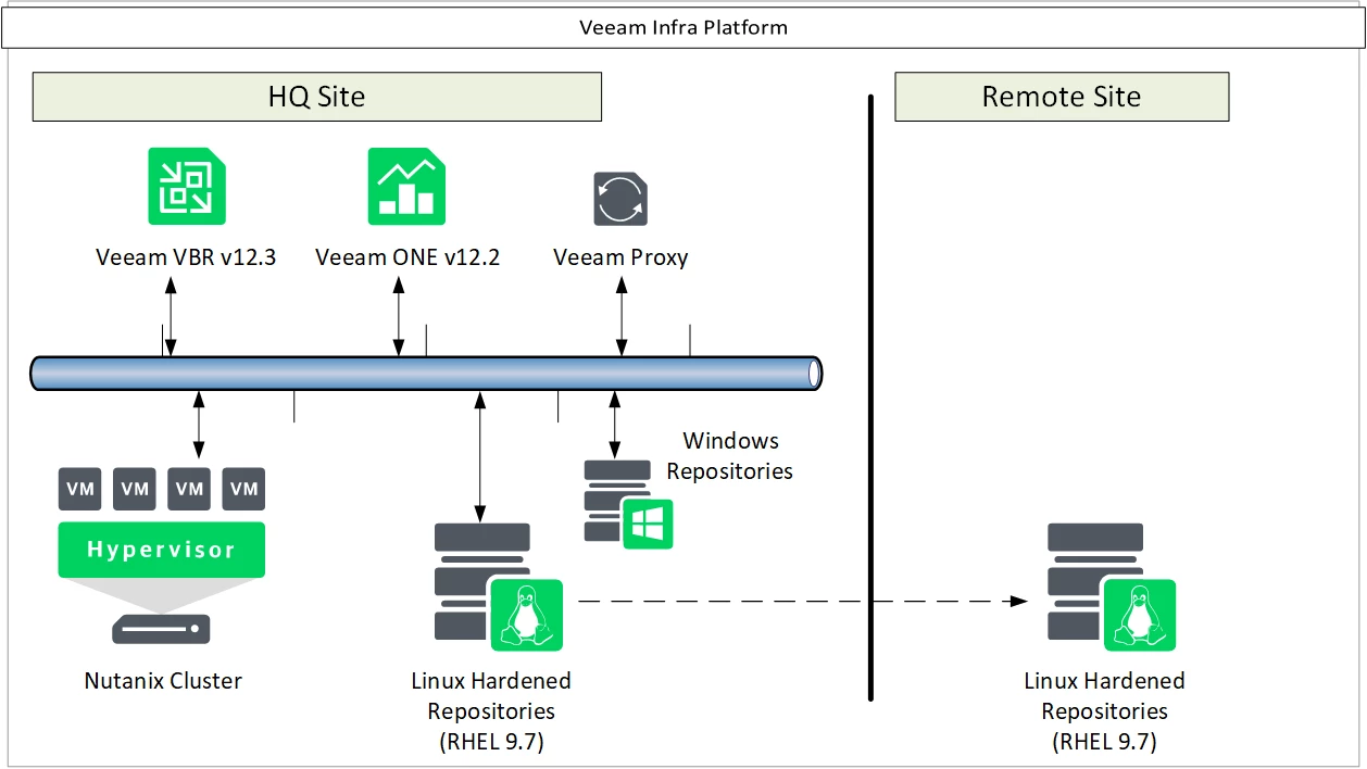

I would like to consult your suggestions and recommendations for my case. Please refer to the Veeam infrastructure diagram below. There are two Linux Hardened Repositories in the environment. The customer needs to upgrade the operating system from RHEL 9.7 to a supported version, as RHEL 9.7 will reach end of support soon.
Constraints
  • The hardware for the Linux Hardened Repositories was purchased in 2023, and the customer intends to continue using it.
  • The license subscription of RHEL will expire in December 2026.
  • The customer is planning to upgrade to Veeam v13.

Hi ​@victorwu , you wrote RHEL 9.7 so I think this means is a manual installation with Disa Stig profile & hardening script. Probably you must verify if 10.x RHEL is compliant with the profile.
Better way, in my humble opinion,  is to use a vm to simulate the upgrade and verify what happens. Try to ask on Veeam Forums too... Probably Hannes or Fabian could have tested this scenario.

Are the VHRs version 1.x or 2.x?  I am not sure if you can just upgrade the OS or not for these, but something to look in to.

Both HRs are the physical server.

I meant was the Veeam VHR ISO used for them or just set up manually?  If the Veeam ISO was used was it 1.x or 2.x version?

@Chris.Childerhose We installed RHEL 9.7 on this server and then configured the hardened repositories manually.

I agree with Antonio here Victor. Maybe cross-check over on the Forums with Hannes to verify.
Let us know what he says.

I will test it on VM environment, thank you for your suggestion ​@Andanet 🤝
