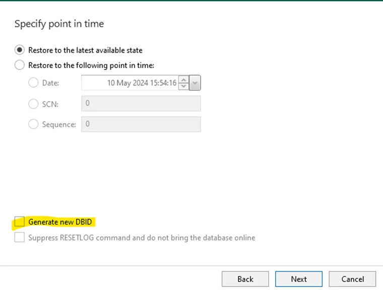

  3. Consider Veeam create a PITR (Point in time restore). When you start a restore you can choice from different solution as image below
 You can generete a New DBID if you want to restore on a different server or database.
During restore task you can see how controlfile, SPFile and all DB files will be restored.
