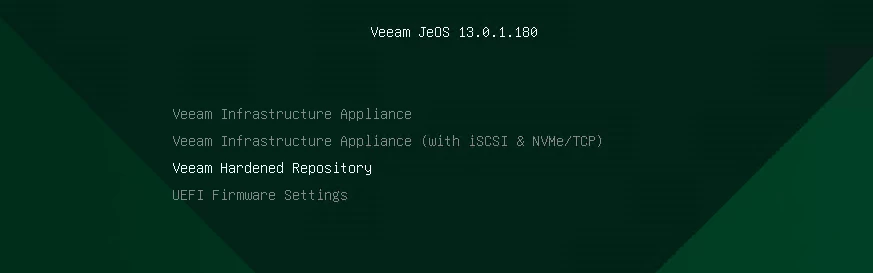

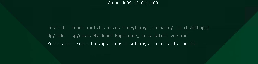

Is there going to be a migration tool or best practice doc to move a physical hard repo (Ubuntu) to a new v13 hard repo appliance? Thanks
Chris.Childerhose
Forum|alt.badge.img+23
I would assume you add the VHR Appliance and then move the backups within the console from one repo to the other.  In the Backups section on the Home view you can right-click a job and then select Move Backups.
Rick Vanover
Forum|alt.badge.img+10
  • Author
  • RICKATRON
  • Dec 17, 2025 7:58 PM UTC
Hi ​@DARIT  - the safe way is to use SOBR & Seal. I realize that isn’t suitable for everyone, but also keep in mind - that there Veeam Infrastructure Appliance .ISO has the ability to take the data to a new VHR format.  This is the separate download that’s only like 1.8 GB and will be roles like repository, proxy, etc.
The boot option gives this:
Then this:
I need to write that up or play with it in the lab. I want to be 100% certain from my old VHR’s that it will leave the volumes/paths that have backups…  Then a scan for backups on configuring new VHR to import to the console.  100% must test this with your environmental-specific config!
