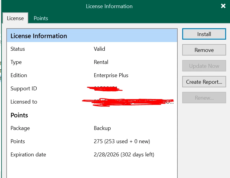

Here my license in the VBR
1* VM protected by Enterprise Plus = 11 Points
You can see that in your screenshot or in our helpcenter.
Total Rental Points of your license / 11 = Amount of VM

hi ​@Mildur
So i have 275 point this mean the VBR only can protect 275/11 = 25 VMs and can exceeding up to 30VMs?
yes. A license with 275 Points allows you to protect 25 VMs.
You can exceed by 20% (or 20VMs) but the Service Provider still has to report and pay the overconsumption.

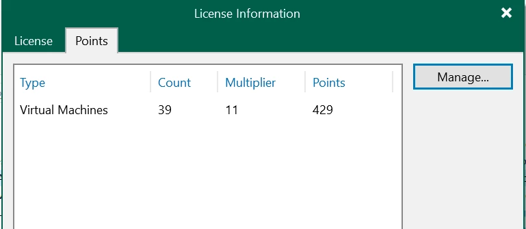

Something is strange with your screenshots. Why is one showing 275 point and the other 429? Different Backup Server?

“Why is one showing 275 point and the other 429? Different Backup Server?”
No i just using single VBR license. Can i say I have 39 VM protected and this mean the point is 429?
My backup job showing i reach the limit of license, so i need to unselect some of my protected VM and want to know actually how much VMs can be protected by my license.
Thats strange. The total point number in the license screen and points screen should match.
I recommend to contact your service Provider. To request a new Rental license with more points and to investigate why the numbers are not matching.

hi ​@Mildur
maybe this is because i have get additional 20VMs since we install the license maybe 2 months ago and today i got error due the grace period is over?
Yes, that could be it.
