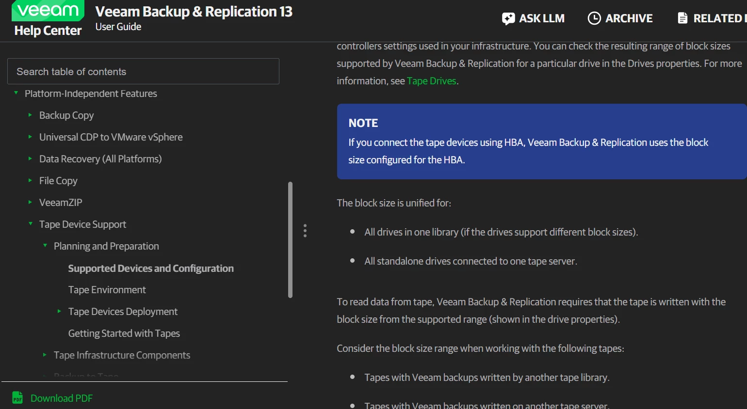

@knorman  Sometimes I still think about some questions, and something just came to mind. Did you check the HBA on your tape server? Take a look at this article and verify the block size as well.
https://helpcenter.veeam.com/docs/vbr/userguide/tape_supported_devices.html?ver=13
