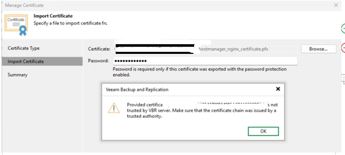

I get this warning when importing the cert.  How could I add root certs to the VSA trust store?
eblack
Forum|alt.badge.img+1
  • Influencer
  • April 1, 2026
On windows you’d add it to the Windows Cert Store but Linux/VSA is another story. I use self-signed on all my VBRs but typically you’d update the Linux store trust. Here is a little more on it but it’s not VSA specific. Maybe someone else can chime in on CA cert trust in VSA. I’m curious myself now not having done it yet.
https://helpcenter.veeam.com/docs/vbr/userguide/tls_internal_ca.html?ver=13&utm_source
  • Author
  • Influencer
  • April 2, 2026
Can someone help me on CA cert trust in VSA ?
eblack
  • Influencer
  • April 2, 2026
I dug deep on this one. If there’s direction on adding a 3rd party (trusted) CA pfx to VSA for 443 I wasn’t able to find it. I may test this with a fresh install soon to see how it behaves with SSH/PS.
