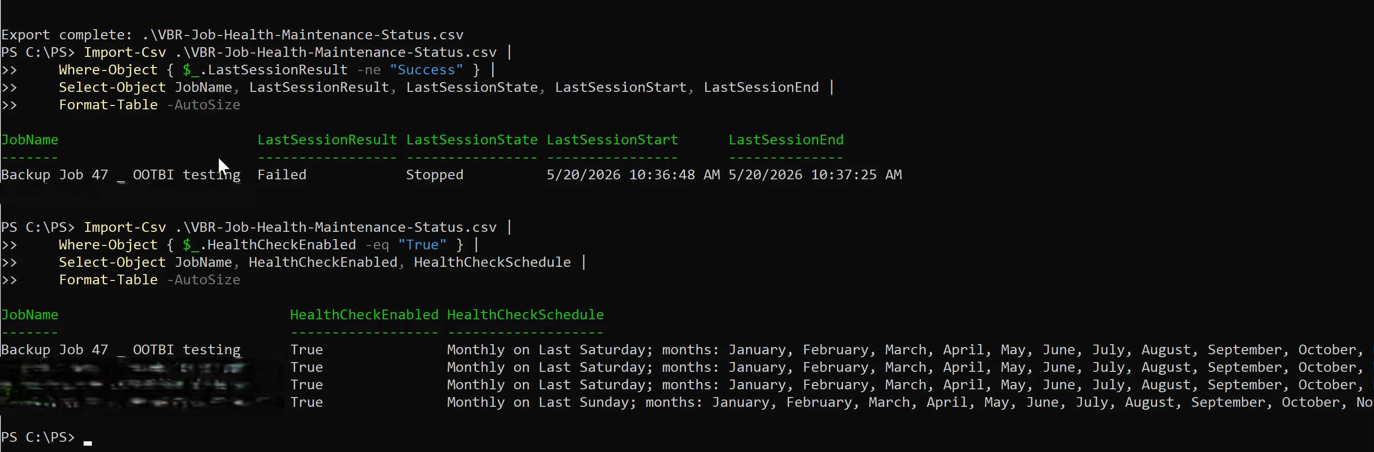

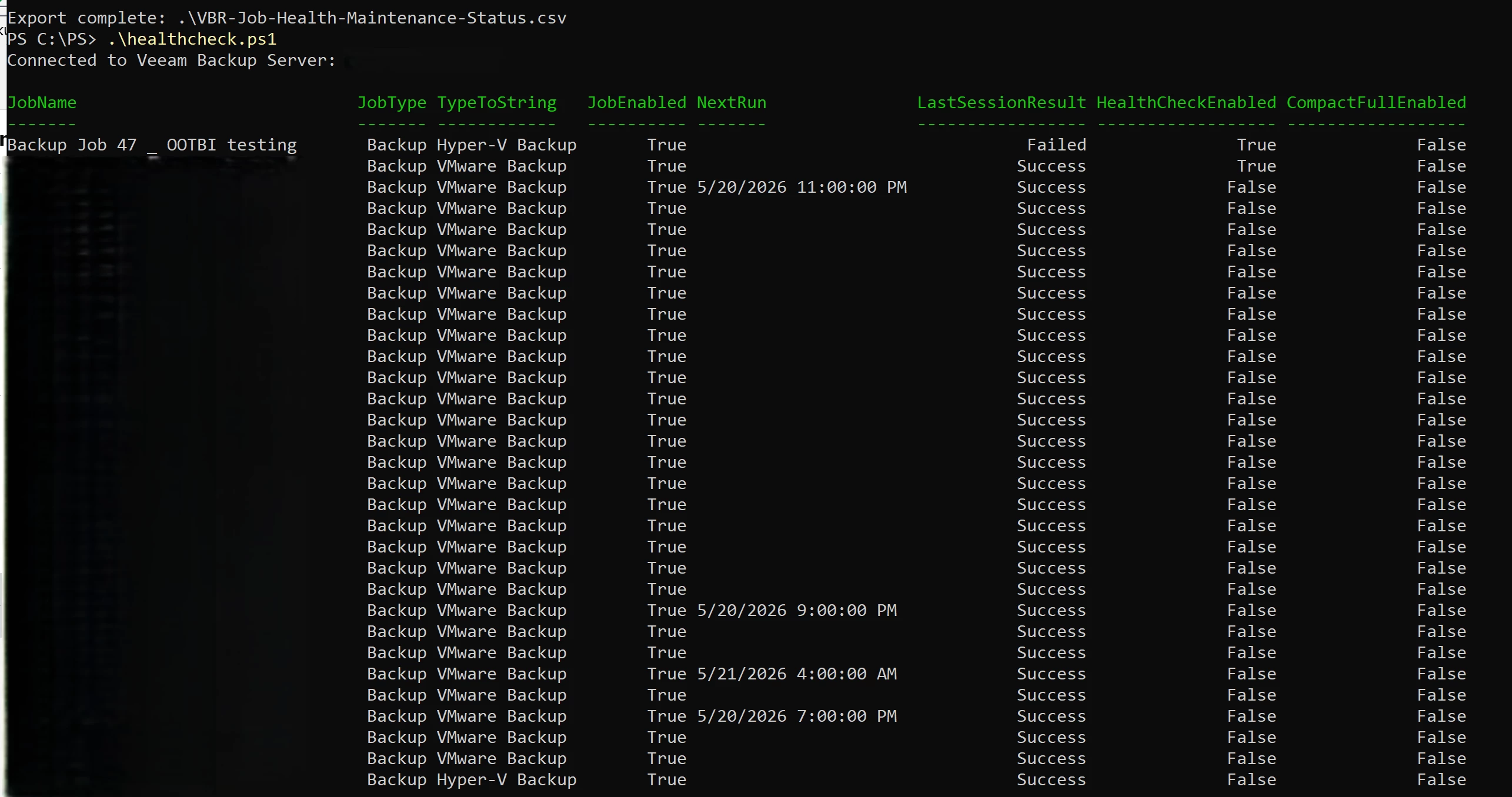

This should work for you, you’ll need to plug the details in for your use case, I had to sanitize it before posting it.

if (-not $report) {
Write-Host "No report rows were generated. No CSV will be exported."
exit 0
$sortedReport = $report | Sort-Object JobName
$sortedReport |
Select-Object `
JobName,
JobType,
TypeToString,
JobEnabled,
NextRun,
LastSessionResult,
HealthCheckEnabled,
CompactFullEnabled |
Format-Table -AutoSize
$sortedReport |
Export-Csv -Path $CsvPath -NoTypeInformation -Encoding UTF8
Write-Host ""
Write-Host "Export complete: $CsvPath"
Write-Host ""
Write-Host "Useful review commands:"
Write-Host 'Import-Csv .\VBR-Job-Health-Maintenance-Status.csv | Where-Object { -not [string]::IsNullOrWhiteSpace($_.LastSessionResult) -and $_.LastSessionResult -ne "Success" } | Select-Object JobName, LastSessionResult, LastSessionState, LastSessionStart, LastSessionEnd | Format-Table -AutoSize'
Write-Host 'Import-Csv .\VBR-Job-Health-Maintenance-Status.csv | Where-Object { $_.HealthCheckEnabled -eq "True" } | Select-Object JobName, HealthCheckEnabled, HealthCheckSchedule | Format-Table -AutoSize'
Where-Object { $_.LastSessionResult -ne "Success" } |
