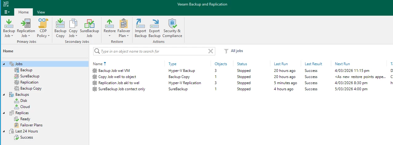

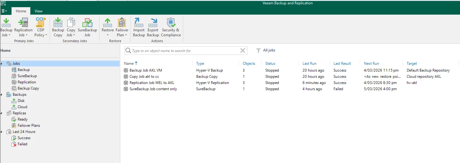

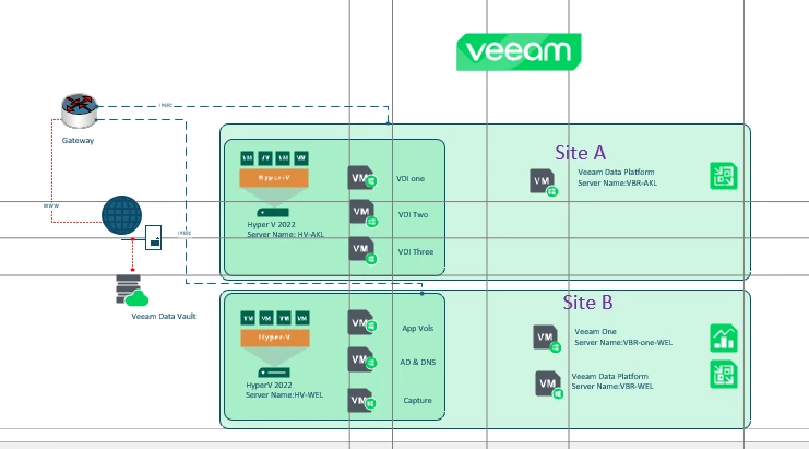

Jason Orchard-ingram micro
Forum|alt.badge.img+5
NemanjaJanicic
I’ve build a similar model for a customer a few weeks ago as a proof of concept.
Site A backup jobs
  • Backup job local Hyper VM storage on local disk repo
  • Backup copy to Veeam Data Cloud Vault for remote recovery (Immutable storage)
  • Replication form Site B for VM (Pulled from site B)
  • Surebackup to verify backup are good 3-2-1-1-0
Site B backup Jobs
  • Replication form Site A for VM (Pulled from site A)
NemanjaJanicic
Site A backup jobs
Site B backup Jobs
