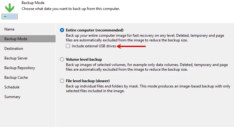

Are you able to see volume G: in Disk Management console?  If so the agent should pick it up as it picks up USB drives fine.  Also try to check the following checkbox for the job to see if that helps -

The FC drive might need to be treated as a “external USB drive” even though it is technically not.

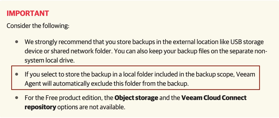

You aren’t using that same FC storage to place your backups in by chance, correct? I assume some Repo on your VBR server? If you are, that is a problem. See below:
VAW Backup Destination Cosniderations

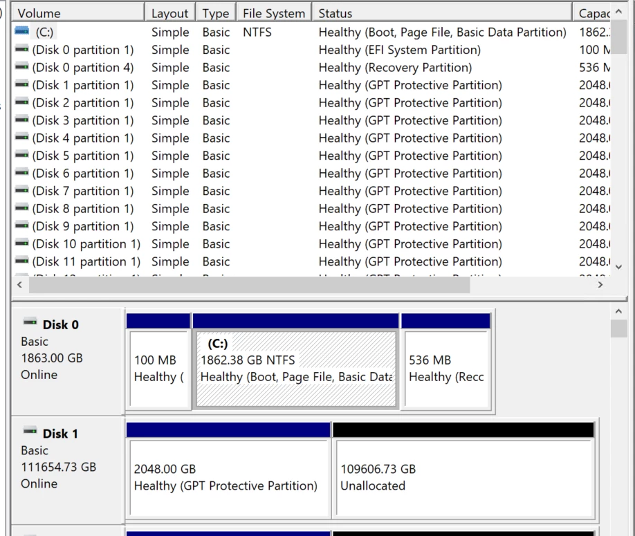

Thanks for your comment. In Computer Mgmt all the LUNs are shown, rather than G: (which is comprised of these LUNs). FTR it’s a StorNext SAN.
That’s right, it’s backing up to a repo on the VBR server.
If that is the case not sure you can back that up.  You might be better at this point to open a ticket with Support to ask them or also check on the Forums - https://forums.veeam.com to see if there is anyone else there that has tried this.  I know there are caveats like Shane mentioned.

Maybe i’ve gone blind, but I don’t see the G volume listed in diskmgmt screens there.
Can you tell a bit more about how you configured G:\ volume? I see the disk online but doesn’t look to have a volume associated with it?
