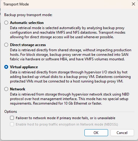

Thanks Matheus for the tip, I don’t have those exact options but I changed it from Automatic to Virtual appliance. I’ll check and see if it works with the offsite

Please ​@ITKM set the Failover option too.
