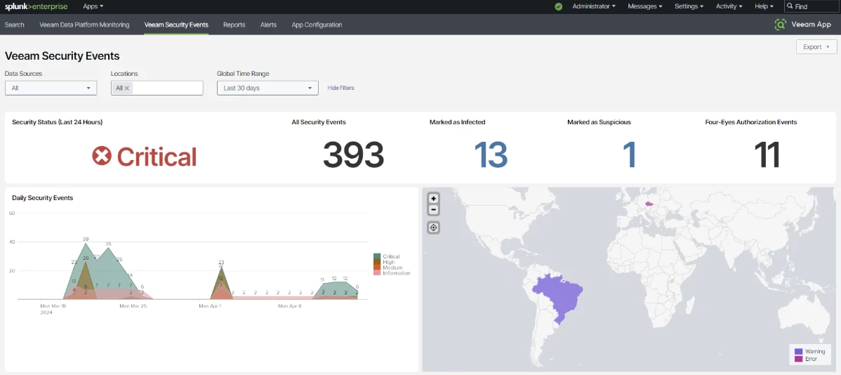

First ensure baseline logging and dashboards are setup.  Veeam has actually done a very good job of making this easy 😁

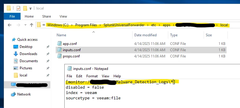

You then need to install a Splunk Universal Forwarder on the VBR server to collect the additional context data:

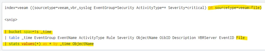

Now you are ready to correlate the Malware Detection events with their contextual data in a custom Detection Alert for your SOC:
  • only the “ObjectName” field is present in both the Malware Detection event and the log files
  • you need to use the timestamp and the ObjectName to correlate these data sources together
  • THERE IS A LOT OF NUANCE IN THE <snip>ed SECTION BELOW (I can help if you need it, but it was too much to post and needed to be sanitized anyway)

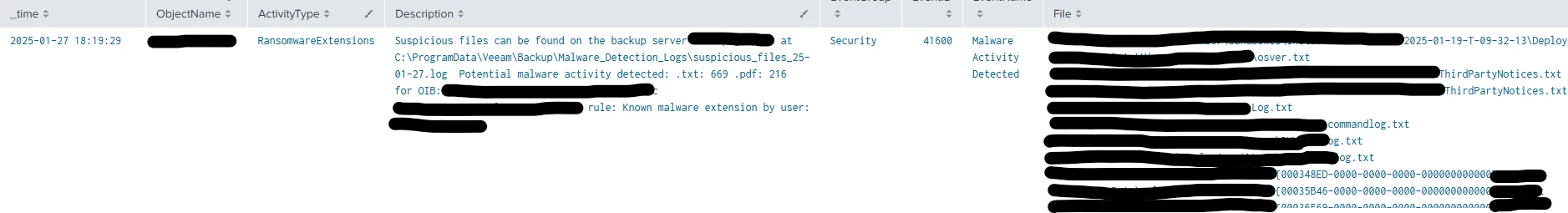

You will now see contextual data embedded directly into the SOC alert (we were doing some testing and set .txt and .pdf as bad file extensions just to generate data 😋):
