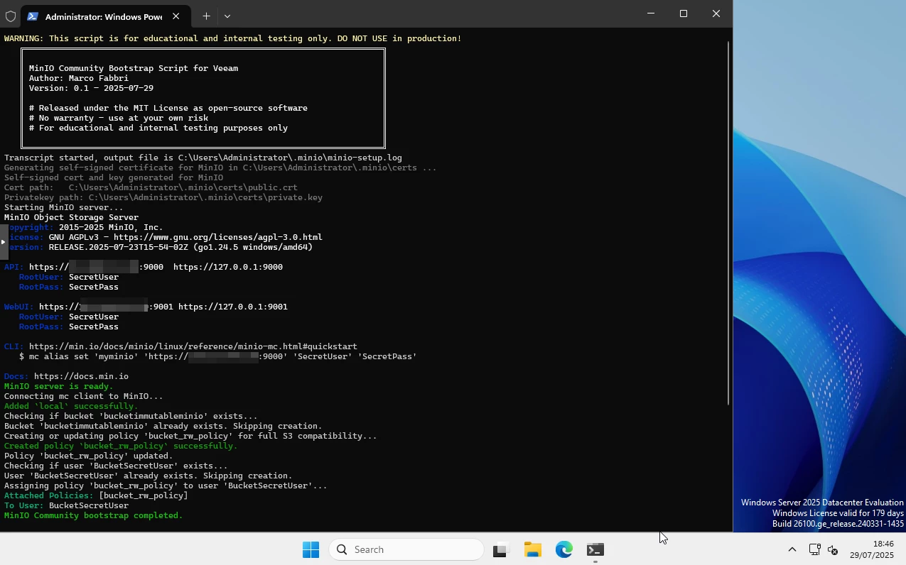

The powershell script
I vibe-coded a PowerShell v7 script that works OOTB, designed to run at system startup. It's placed in C:\Minio\ alongside the MinIO server and client executables. The script handles:
Relaunching itself with PowerShell 7 if executed from an older version
- Starting the MinIO Server Community executable using hardcoded credentials defined at the top of the PowerShell script
- Connecting the MinIO Client (mc) Community to the local server

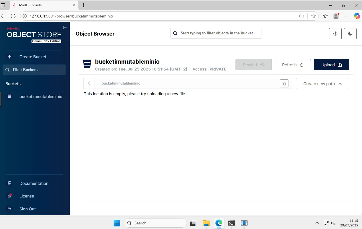

- Creating a bucket and assigning it a full S3-compatible policy if it doesn't exist
- Creating a limited user and assigning the policy required for Veeam integration
- On the first run, it auto-generates a self-signed certificate stored in
%USERPROFILE%\.minio\certs\ - Logs everithing in
%USERPROFILE%\.minio\minio-setup.log
Unlike previous setups, I deliberately avoided using Windows environment variables globally, to ensure sensitive credentials are not exposed to subprocesses and as you can see, the config parameters are clearly defined at the beginning of the script for easy customization before execution. Btw, the certificates should remain in the folder where they were generated, to ensure compatibility with MinIO Server Community.

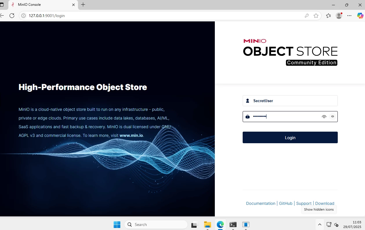

This is version 0.1, there’s definitely room for improvement.
With this setup, the service starts up and is accessible via HTTPS (using a self-signed certificate) from a browser.
And everything is ready to proceed with the configuration inside Veeam.

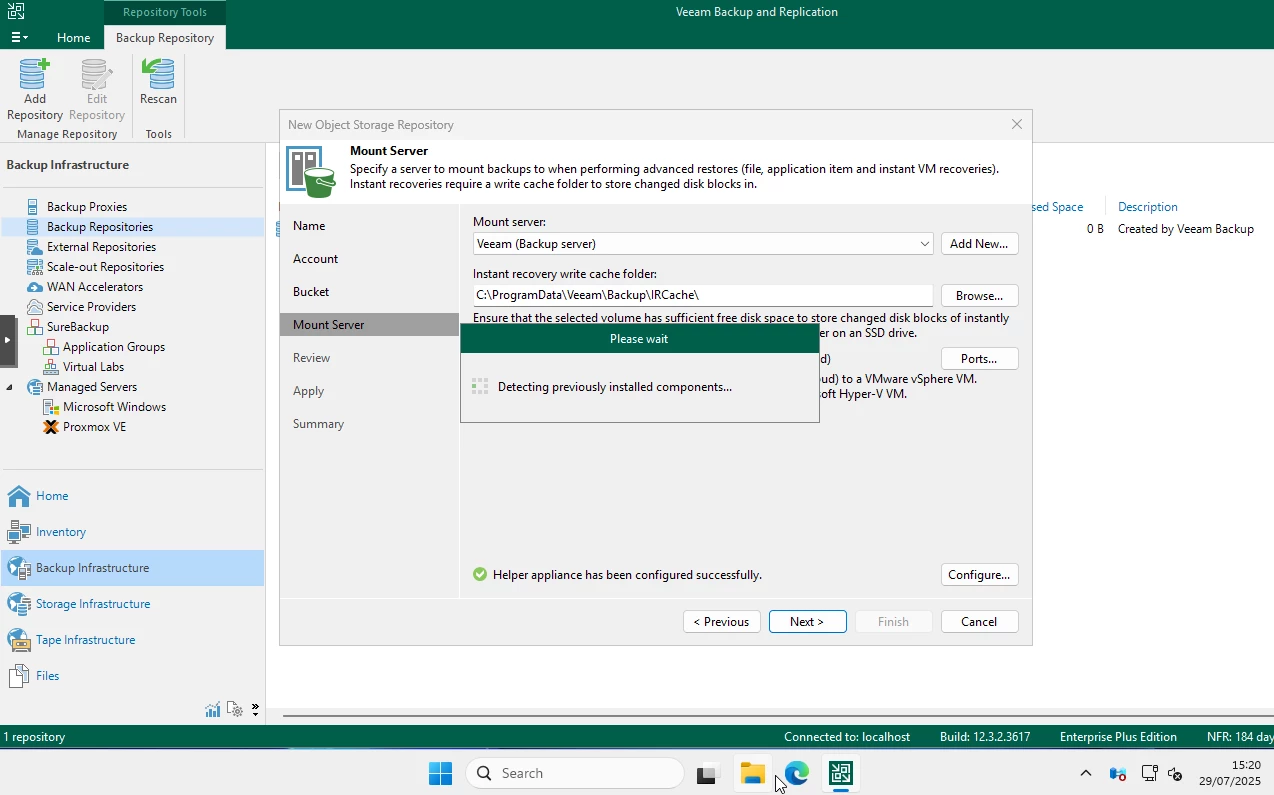

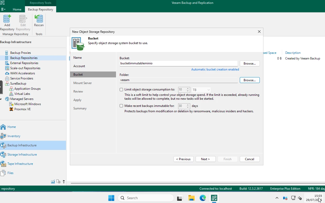

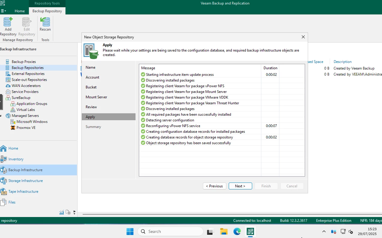

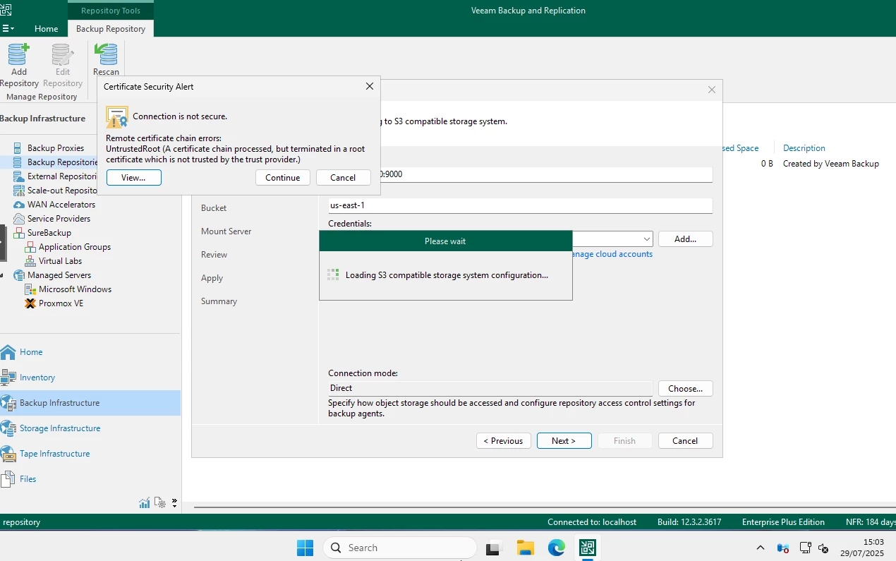

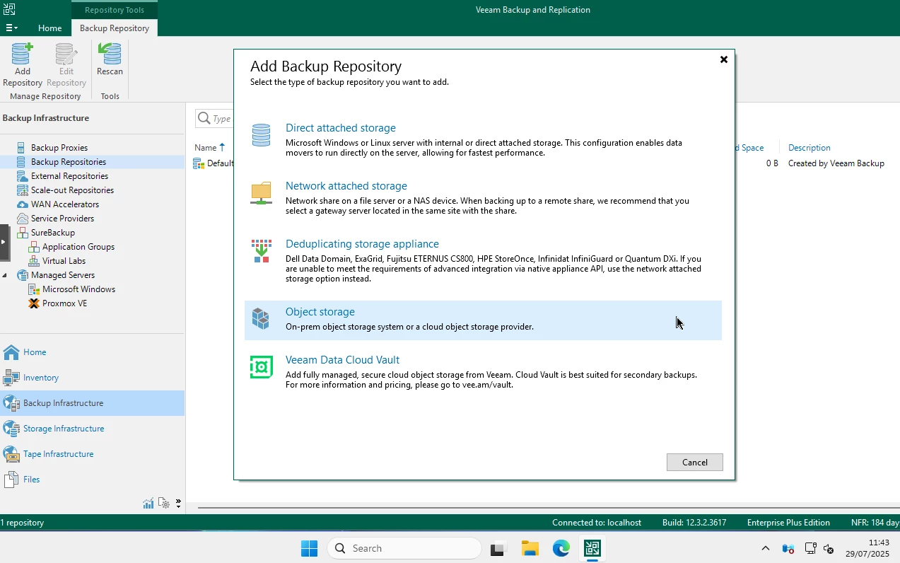

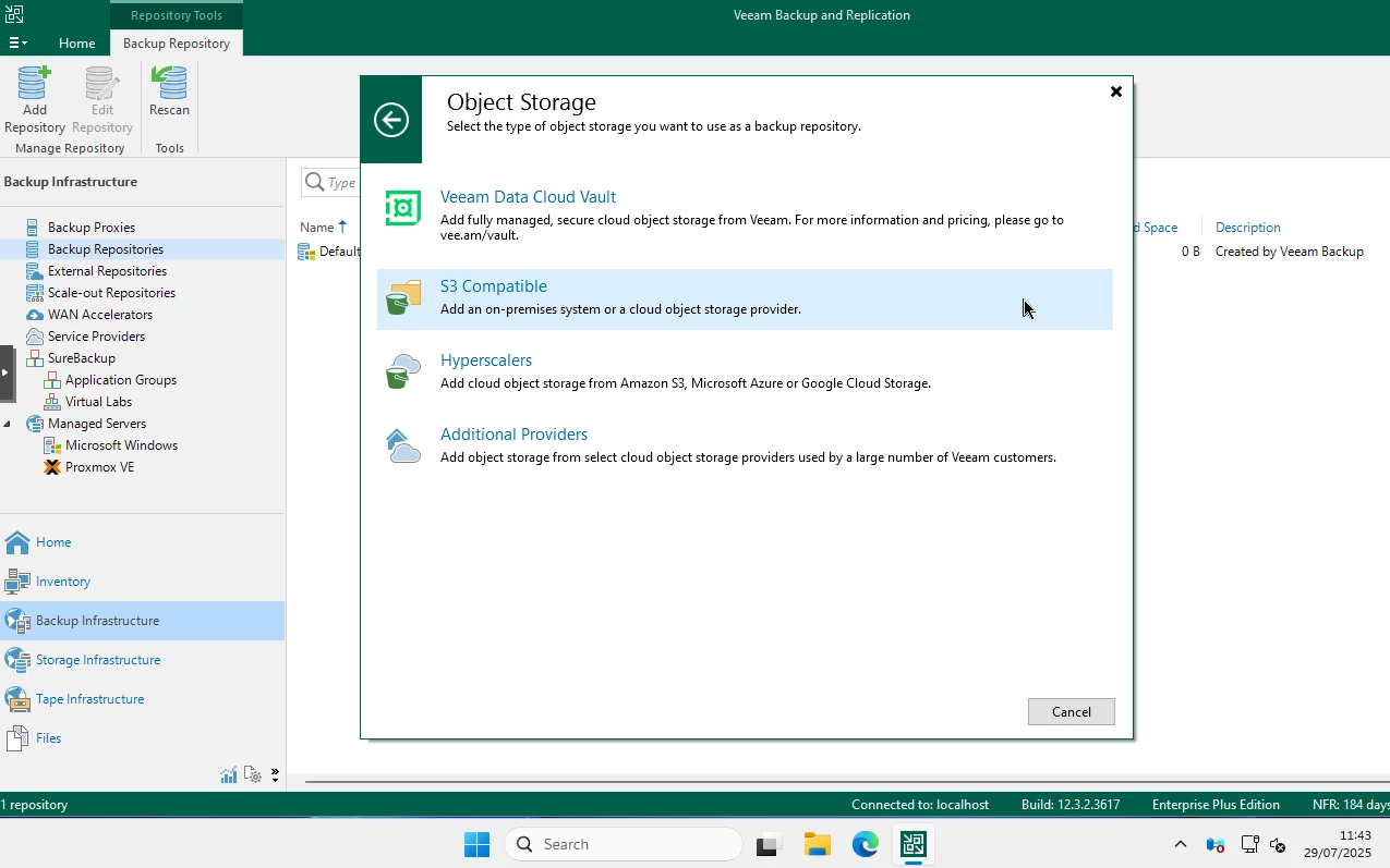

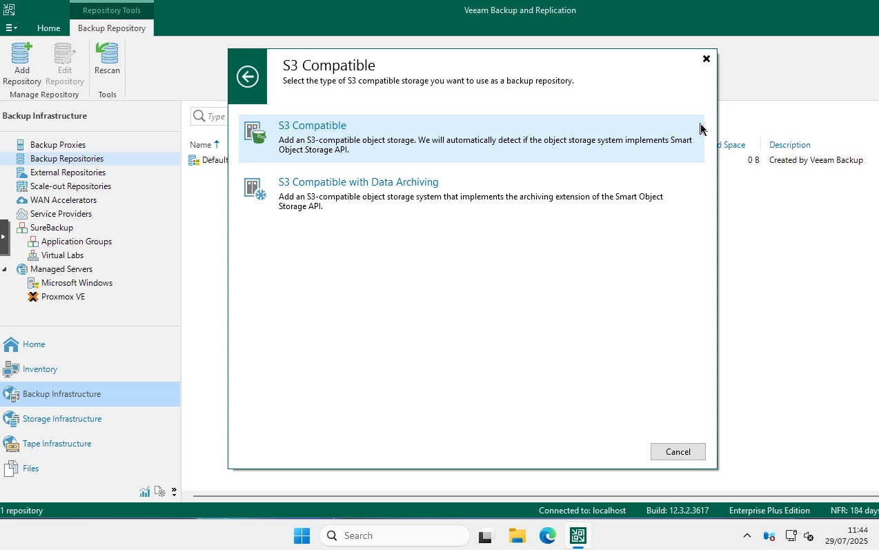

Configure your Object Storage Windows server on Veeam

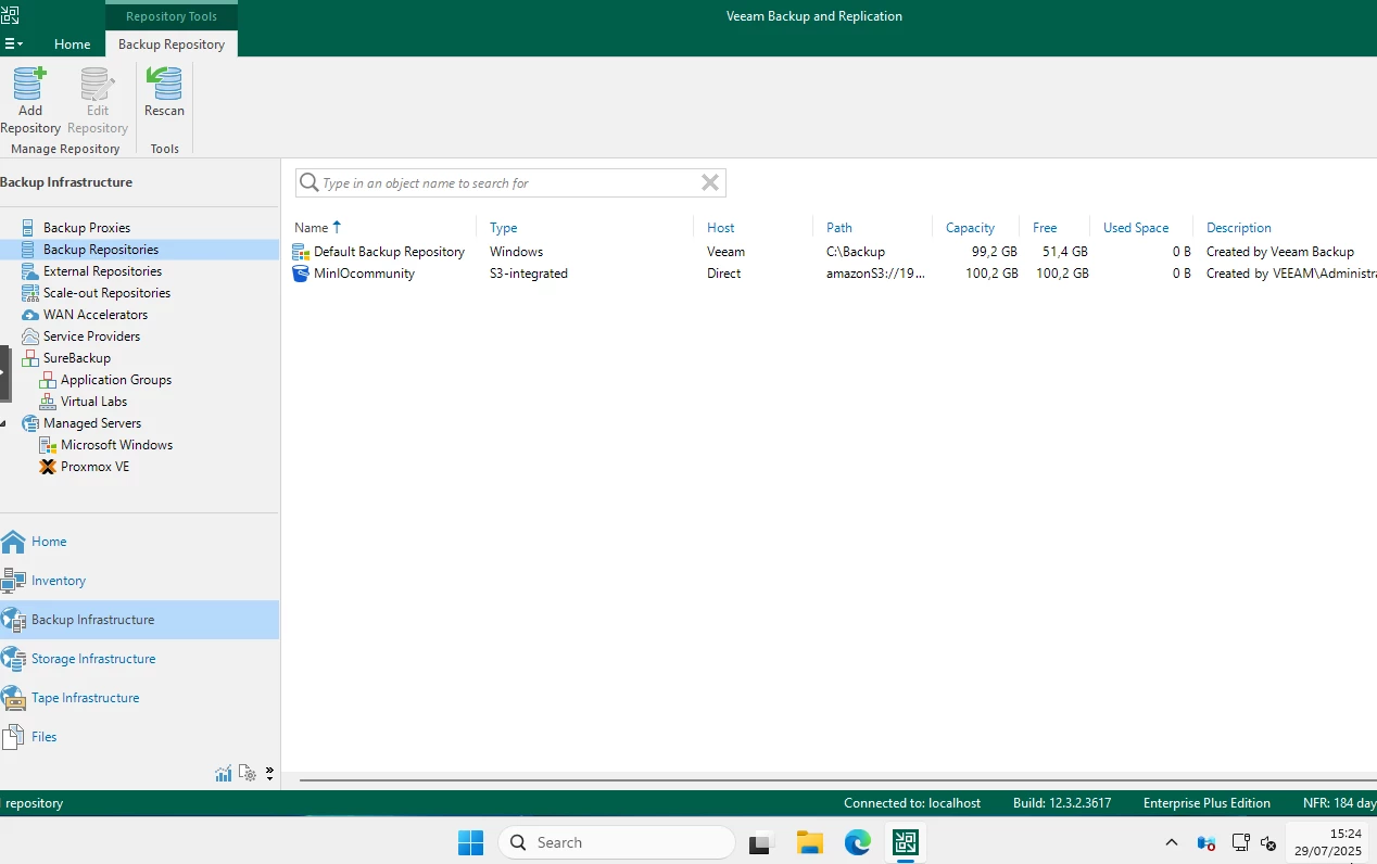

Now, configure your Veeam Server by adding an S3-compatible Object Storage repository. Not much has changed since the previous topic.
That’s it, now you can start playing with your backups and deepen your Object Storage backup knowledge along the way 👹
