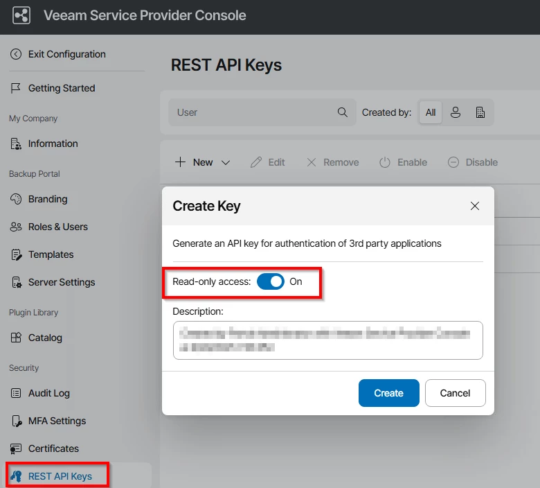

A note on security
Because a single API key can reach all your servers, it’s super important to keep it safe. Treat it like gold. 😄
When you create an API key, you can also enable “read-only access.” This applies not only to calls against VSPC itself but also to all proxied requests to your Veeam servers. If you’re just pulling information (like in my demo), enabling read-only is the way to go.
You can find the official documentation for this feature here: https://helpcenter.veeam.com/docs/vac/rest/proxying.html?ver=9

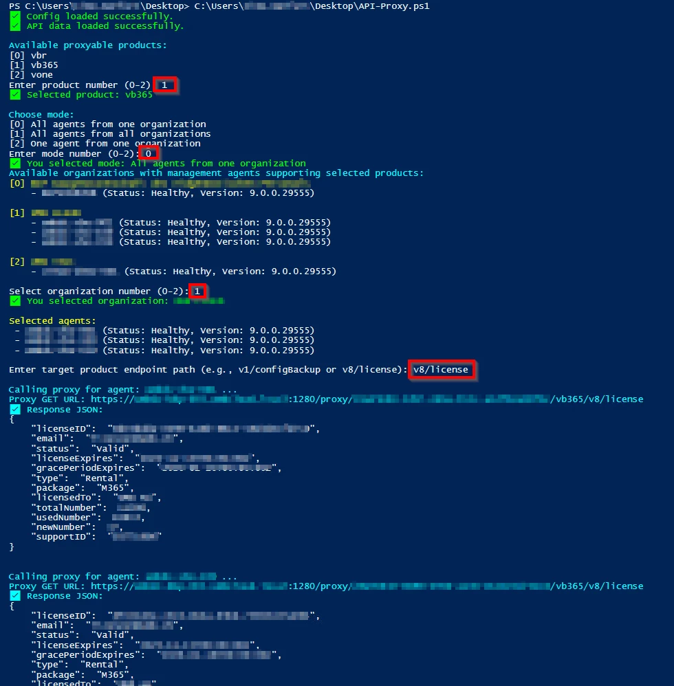

I decided to dive in and do some scripting myself—the script is attached to this post. Essentially, it’s a wrapper for GET requests to one or multiple destination Veeam servers, and it really highlights the power this feature gives us as service providers.
The script does only GET requests. And if you enable read-only access to the API key, nothing can break 😁
Here’s a quick overview of how it works:
The script requires a config.json file in the same directory (or you can update the script to point to a different location). This config file also specifies the location of your API key.
Here’s an example config.json file:
  "ApiKeyPath": "C:\\Users\\xxx\\Desktop\\api-key.txt",
  "Server": "vspc.domain.com",
  "Port": 1280,
  "ApiVersion": "v3"
With this setup, the script reads the config, authenticates with VSPC using your API key, and can send GET requests to your managed Veeam servers effortlessly.
Here’s how the script works:
  1. Load the config: The script starts by reading the config.json file and retrieving all organizations and their management agents via an API request.
  2. Select the Veeam product: Choose which Veeam product you want to send the API request to
  3. Choose the target agents: Decide whether to run the query against all agents, all agents within a specific organization, or just a single agent.
  4. Select the organization: Once chosen, the script lists all compatible agents within that organization.
  5. Enter the API request: Finally, input the exact API request you want to run.
After that, the script returns the response from the agent—or agents—you queried, giving you direct insight into your managed Veeam servers.
