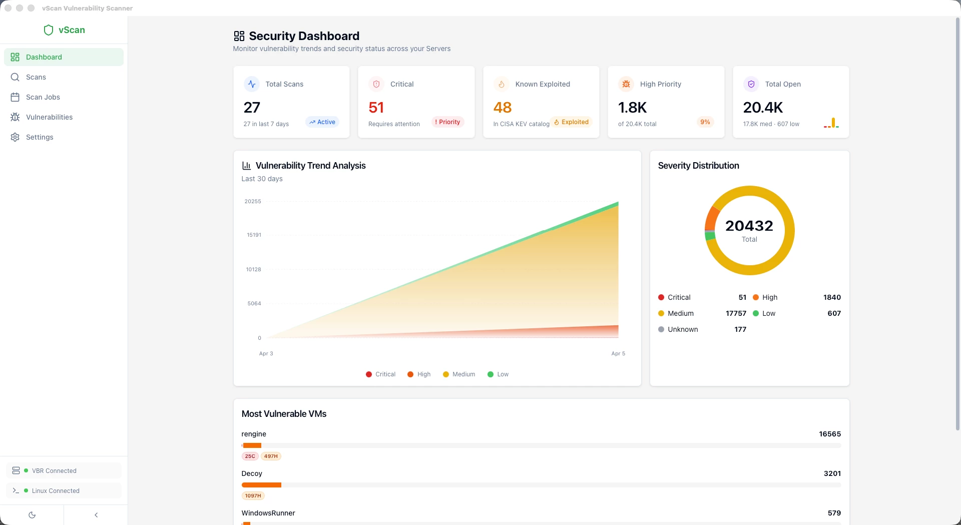

I'm really happy to share with the Veeam Community the release of vScan 2.0, a complete rebuild of the vulnerability scanner for Veeam Backup & Replication.
For those who don't know vScan, you can check the original post here: vScan v1 – Vulnerability Assessment in your Veeam Backups
Since the v1 release, I received amazing feedback from the community (thank you all!) and many feature requests. Instead of patching v1, I decided to rebuild the entire application from scratch with a completely new architecture, new features, and addressing all the questions and requests from the community.
What Changed from v1 to v2?
Everything. Here's a quick comparison:
  v1 v2
VBR Connection PowerShell Module REST API (native HTTP)
Requires VBR Console Yes No
Installer Size ~200MB ~15MB
RAM Usage ~400MB ~80MB
Antivirus False Positives Frequent (Chromium) None
Scanner Engines Trivy, Grype Trivy, Grype, Jadi
Vulnerability Tracking Per-scan only Full lifecycle management
Batch Scanning No Yes
Scheduled Scans No Yes (cron)
PDF Reports No Executive + Technical
CISA KEV Integration Basic Auto-sync every 24h
Security Basic AES-256-GCM, Argon2id, Biometrics
Platforms Windows only Windows + macOS
The biggest change is that vScan no longer requires the VBR Console or PowerShell Module installed. It connects directly to the VBR REST API on port 9419, which means you can run it from any workstation, not just the backup server.

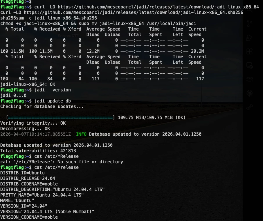

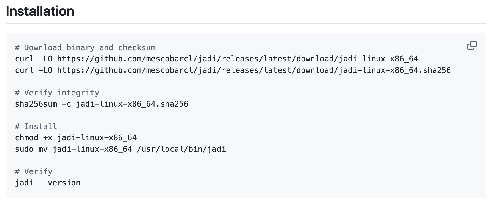

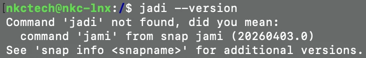

Hey ​@Marco.Escobar ..I tried to install one of your scanners (jabi)..and wasn’t able to. Install instructions are pretty straight forward.
Jadi Install
I know it’s not a requirement to use your tool, but I wanted to try and get it installed (it didn’t install during vScan deployment). I did everything in the procedure above with no issues, but when I went to get the Jadi version I got the below:
Jadi Version Error
I’m running Ubuntu 22.04, and x64. Thoughts?
Forum|alt.badge.img+3
  • Author
  • Comes here often
  • April 7, 2026
Use Ubuntu 24.04 or any Linux x86_64 with glibc 2.39+ the mayority of linux distros updated have Glibc 2.38+

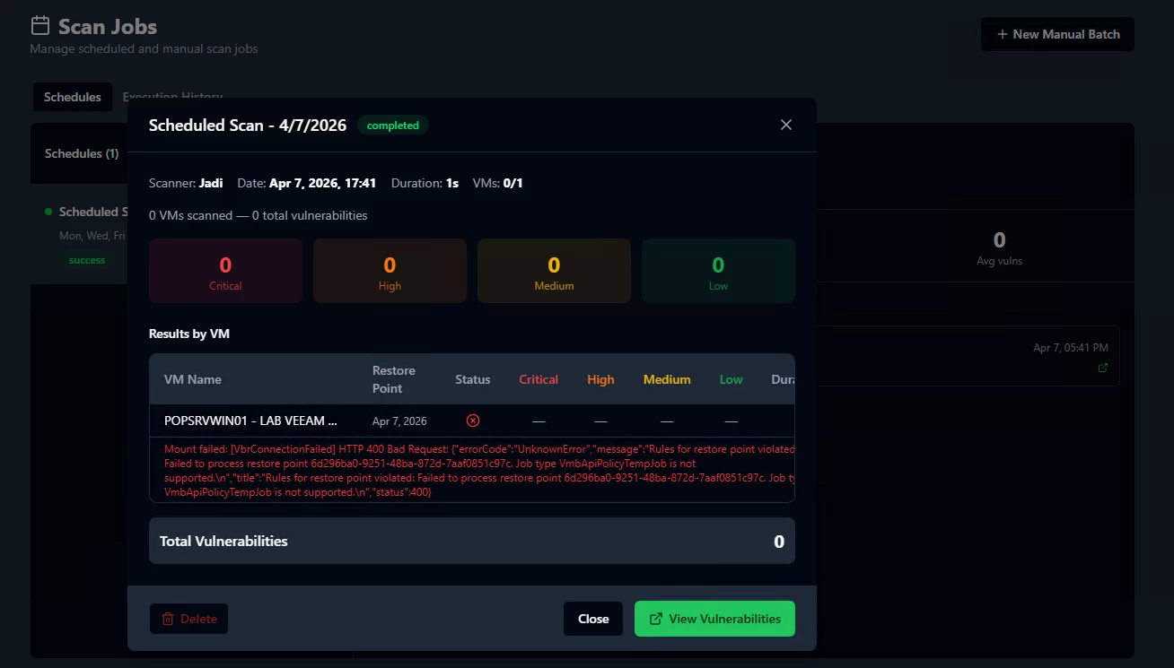

wolff.mateus
Forum|alt.badge.img+12
  • Veeam Vanguard
  • April 7, 2026
Nice tool ​@Marco.Escobar!
I tried it here and I connect on my VSA v13 correctly with no issues.
However I got this error below when I try to scan a job:
This is a lab environment running over a Nutanix AHV.
  • Author
  • Comes here often
  • April 7, 2026
Confirmed, that error is from the VBR REST API, not vScan. The "Job type 'VmBackupPolicyTempJob' is not supported" message is what VBR returns when you try to publish disks from a backup created by the Veeam Plug-in for Nutanix AHV.
Could you open a GitHub Issue with the vScan logs attached? I'd like to review how to solve this.
Logs location: macOS:   ~/Library/Logs/vScan-Vulnerability/vscan.log, Windows: %APPDATA%\vScan-Vulnerability\logs\vscan.log
