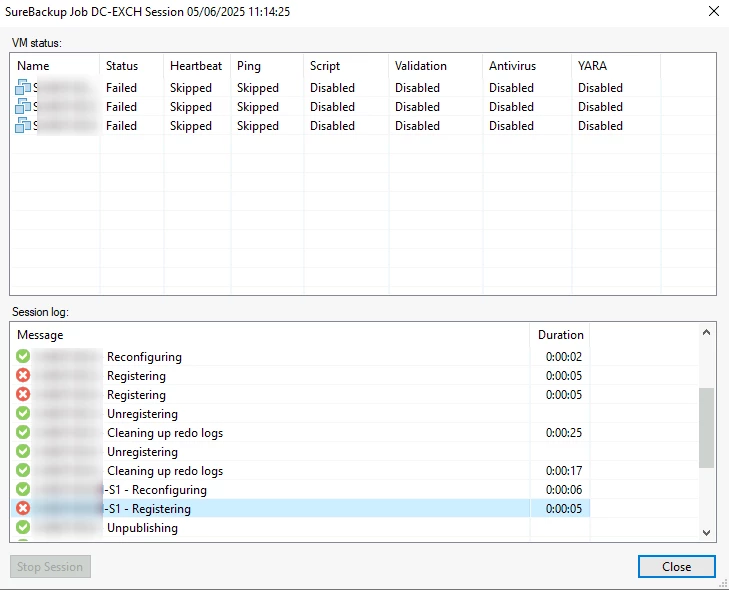

Suddenly the SureBackup starts to fail. When the SureBackup job launches, it fails during VM registration with vCenter

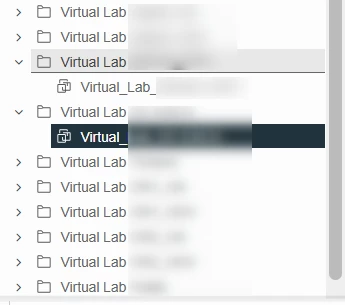

On the vCenter side, all virtual labs are presents in their respective folder.
But I noticed that the Resource pools are all missing.

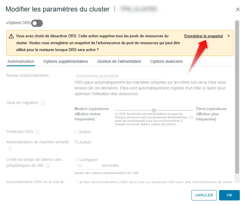

You may turn off vSphere DRS for a cluster.
If you disable vSphere DRS, the resource pools are removed from the cluster.
When vSphere DRS is disabled, the cluster’s resource pool hierarchy and affinity rules are not reestablished when DRS is turned back on.
To avoid losing the resource pools, save a snapshot of the resource pool tree on your local machine.
You can use the snapshot to restore the resource pool when you enable vSphere DRS.
When we edit the setting for the DRS cluster and choose to disable DRS we are presented with a warning and asked if we wish to create a snapshot of the resource pools and also the location for the snapshot.

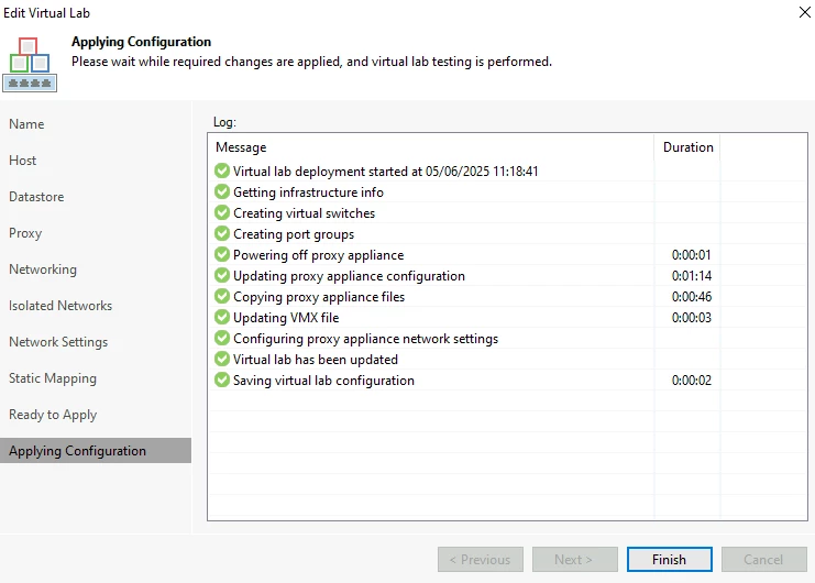

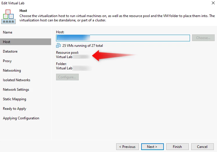

In my case: Unfortunately, my client didn't create this snapshot. So I tried to reapply the Virtual Lab configuration from Veeam. The resource pool is properly mentioned.
The configuration finish properly
But the Resource Pool is not recreated…
I also try to create from scratch a new resource pool from vCenter and assign my virtual lab but the job still failed.
