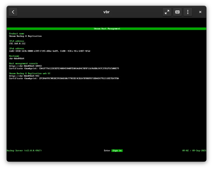

When you open Gnome Boxes, VBR will be running on your main network.
Finally you can now things like make screenshots. Perfect for documentation for example.
