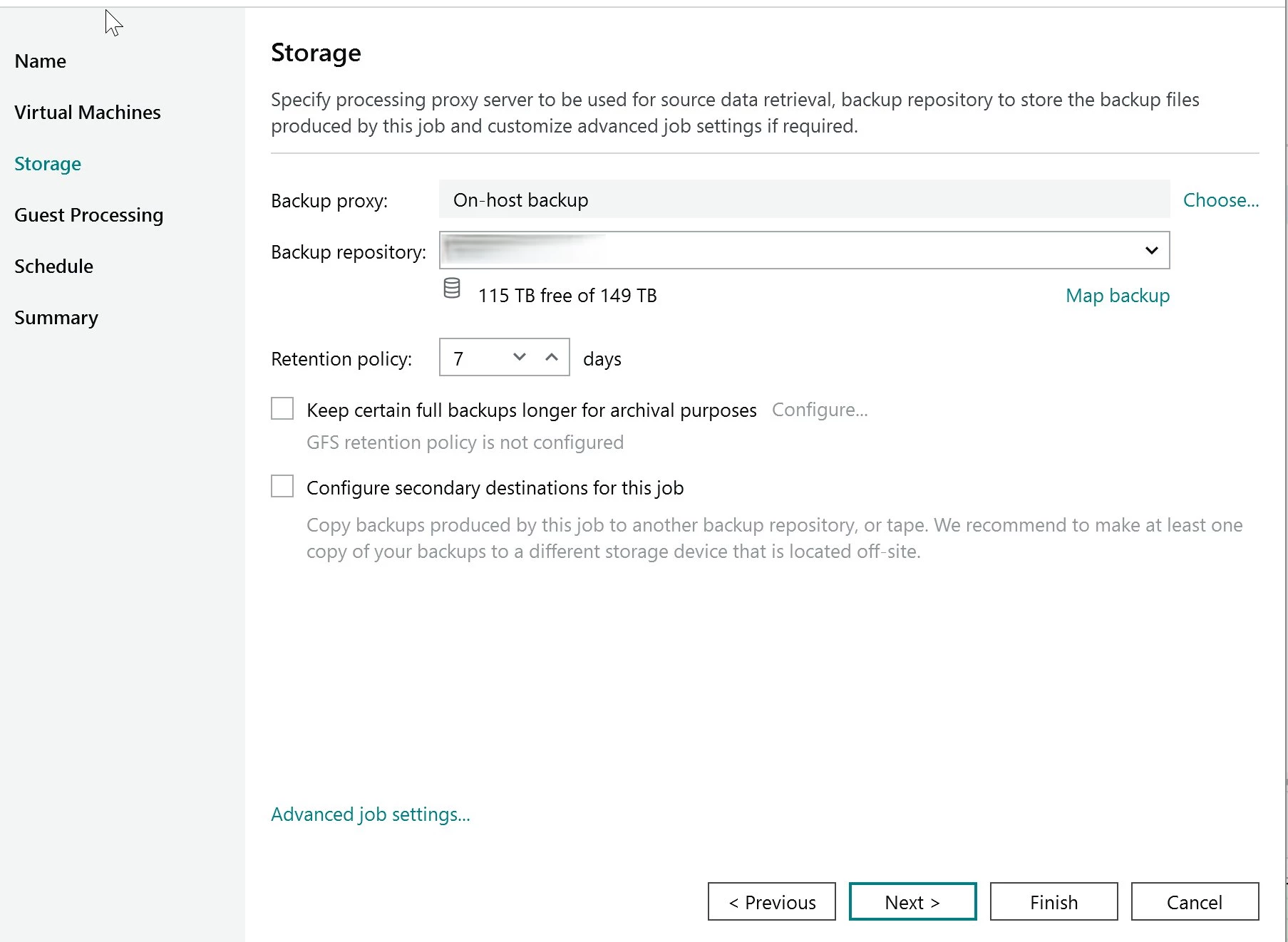

The backup mode is set per job in the job properties. Not a global setting. The backup proxy setting lives on the Storage page of the job wizard, as shown below.

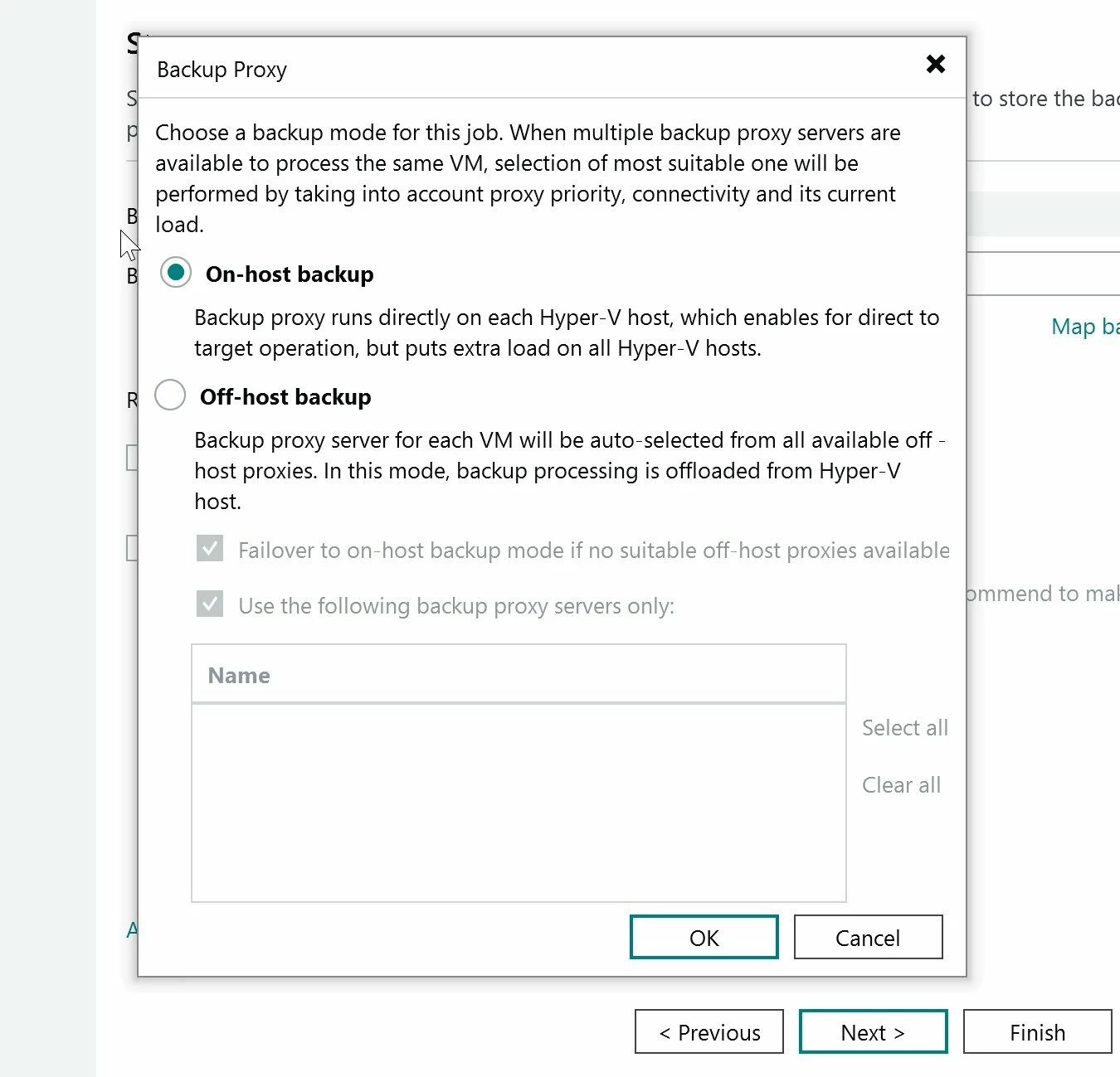

Click Choose to open the mode selection. The Backup Proxy dialog is where you pick on-host or off-host, as shown below.
Notice the failover checkbox at the bottom of the off-host option. If you select off-host and no suitable off-host proxy is available, VBR can fall back to on-host automatically. That checkbox is checked by default. One more place where VBR makes a data path decision for you if you aren't paying attention.
