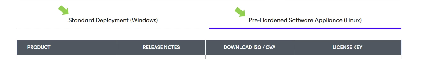

- Where do I download the Veeam Software Appliance? The early release status is downloaded from the Veeam website here (or from My Account). Be sure to click the ‘tab’ for the right mode:
