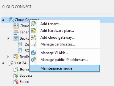

To enable Maintenance Mode from the VBR console Right Click on the Cloud Connect top level tree item and click on Maintenance Mode
Read the message and click Yes

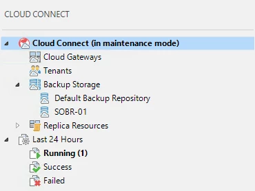

Once completed you should see the following status in the Cloud Connect menu tree

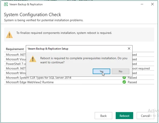

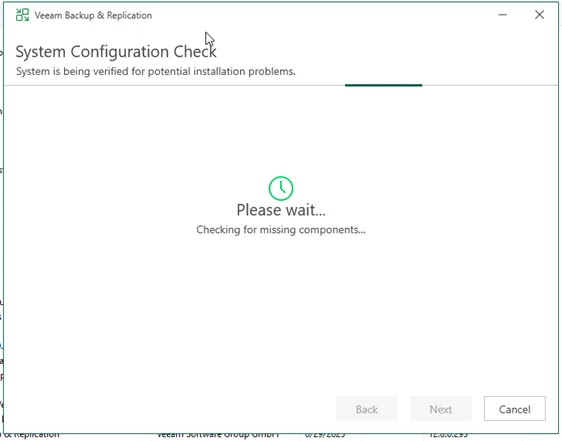

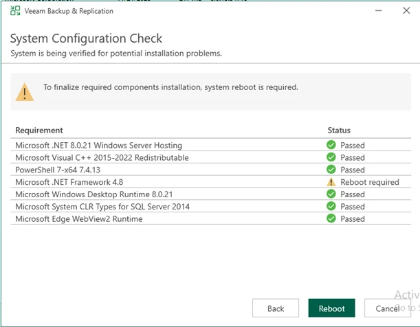

System configuration check
At the System Configuration Check step, the wizard verifies required software components. If anything is missing, the setup installs it automatically. After installation, a reboot may be required. Click Reboot, then restart the setup and continue.
Once the VM is rebooted and online, Start the VBR setup again, Accept the agreement -> License details -> Perform Configuration Check

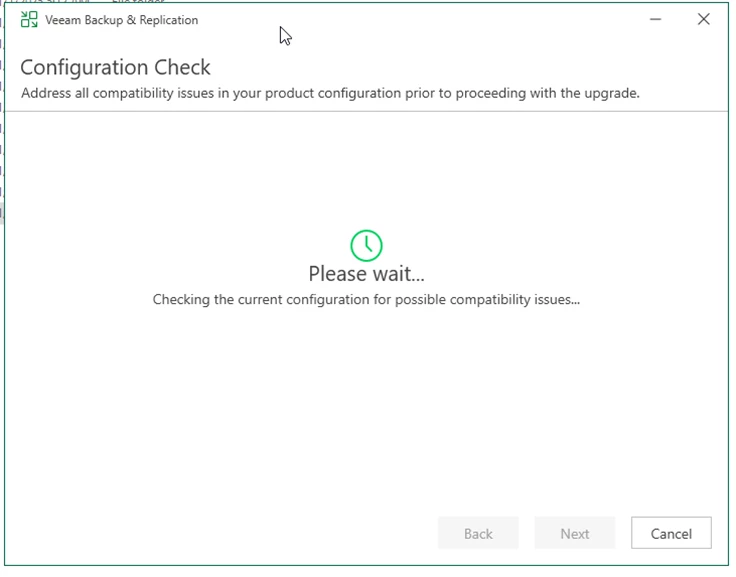

Configuration Check
During Configuration Check, VBR scans your environment for anything that will not survive the move to v13. This helps prevent breakage after the upgrade.

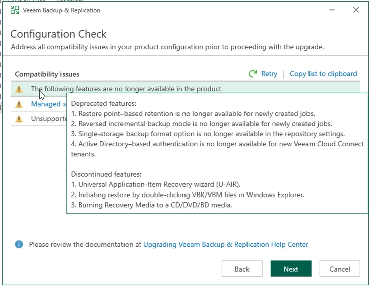

Pay close attention to warnings about removed features.
Deprecated features
  • Restore point based retention
    Earlier you could set retention as “keep 30 restore points” instead of “keep 30 days.” In v13, you cannot configure restore point based retention for new jobs. New jobs must use time based retention.
  • Reversed incremental backup mode
    This mode kept the most recent backup as a full, with older restore points as incrementals. In v13, you cannot create new jobs with reversed incremental mode. Existing jobs may continue to run, but plan to migrate to forward incremental with periodic fulls.
  • Single storage backup format option
    Earlier you could choose the older single chain format at repository level. In v13, this format is no longer available for new repositories or jobs. The supported default is per machine backup chains.
  • Active Directory based authentication for new Cloud Connect tenants
    Earlier tenants could authenticate using AD users and groups. In v13, AD based authentication cannot be enabled for new tenants. New tenants must use local Veeam accounts or other supported methods. Existing AD based tenants are not forced to change immediately, but no new AD based tenants can be created.
Discontinued features
These are fully removed.
  1. Universal Application Item Recovery wizard (U AIR)
    The generic multi app item recovery wizard is removed. Use application specific recovery options instead.
  2. Starting restore by double clicking VBK or VBM in Windows Explorer
    This shortcut is removed. Restores must be initiated from the Veeam console.
  3. Burning Recovery Media to CD, DVD, or BD
    The built in burn option is removed. You can still create ISO or USB recovery media and burn using another tool if needed.

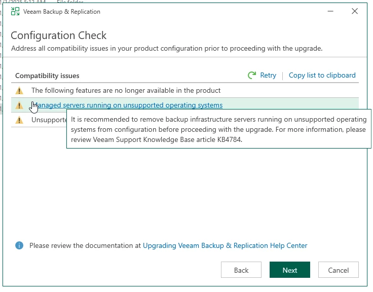

Unsupported operating systems
The Configuration Check also flags managed servers running unsupported Windows versions. Upgrade or remove those servers first, then click Retry to confirm everything is compliant before proceeding.
Unsupported tenant versions
Unsupported tenant version is one of the most critical checks in a Cloud Connect upgrade because it directly affects tenant backup continuity. Tenants on old builds cannot communicate with the provider once you move to v13. After the upgrade, their backup copy jobs, backup to cloud repository jobs, and restore portal operations will fail until they upgrade. This impacts all Cloud Connect traffic, including agent backups, Cloud Connect backup, and Cloud Connect replication if used.
Export or copy the tenant list and contact each tenant to confirm their current build, then schedule their VBR and agent upgrades as soon as possible.

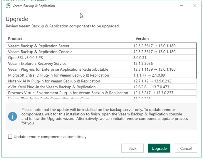

Review the list of Veeam components and plug ins that will be upgraded, then confirm before clicking Upgrade.
Select Update remote components automatically if you want gateways, proxies, and repositories upgraded automatically after the core server upgrade. Otherwise, VBR will prompt you to update them at first launch.

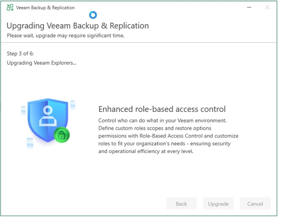

Upgrade execution

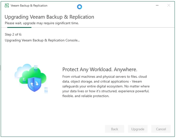

You will see the upgrade progress through six stages:
  1. Upgrading Veeam Backup and Replication Server
    Updates core VBR services, binaries, and configuration.
  2. Upgrading Veeam Backup and Replication Console
    Updates the admin console to match the server version.
  3. Upgrading Veeam Explorers
    Updates application explorers like AD, Exchange, SQL, Oracle, and SharePoint.
  4. Upgrading Veeam Agents redistributables
    Refreshes Windows and Linux agent packages available for push install.
  5. Upgrading plug ins for Veeam Backup and Replication
    Updates platform and integration plug ins such as VMware, Hyper V, Nutanix, Entra ID, and others.
  6. Finalizing installation and starting services
    Completes cleanup and restarts all Veeam services on v13.
Upgrade completed successfully.

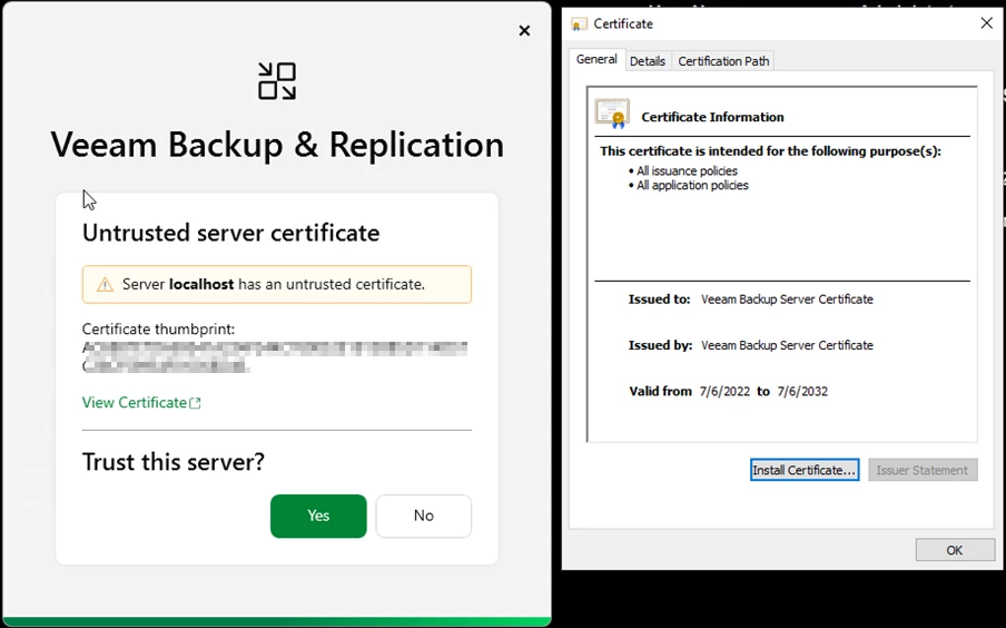

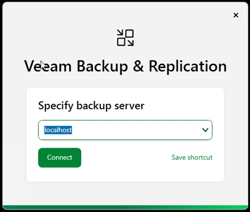

Launch the V13 console
View the certificate and install them locally
I really love the new UI look!
