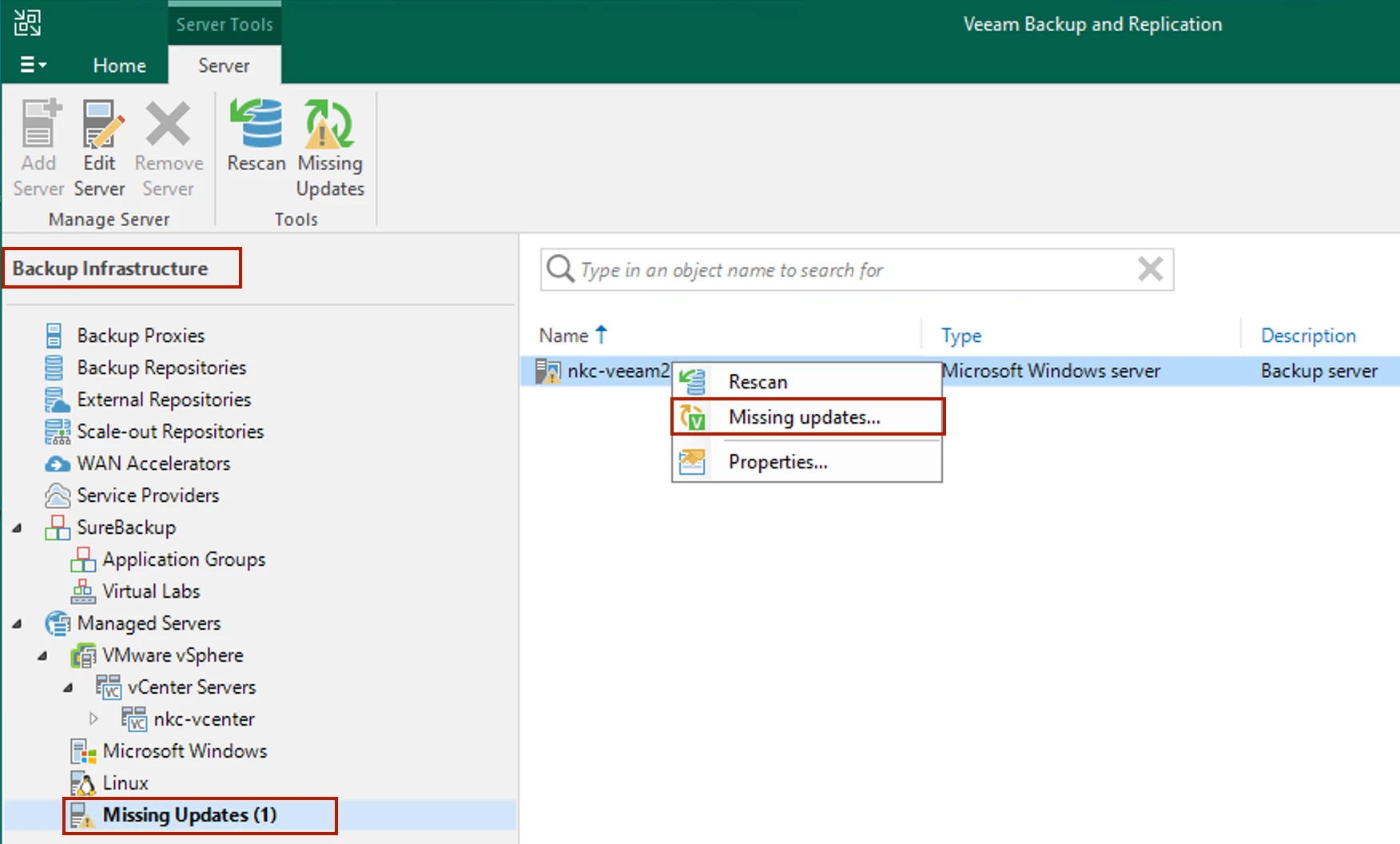

The resolution is easy enough. From the Backup Infrastructure View/Node > Managed Servers > Missing Updates , rt-click on your VBR server on the right and select Missing updates…
VBR Console Missing Updates

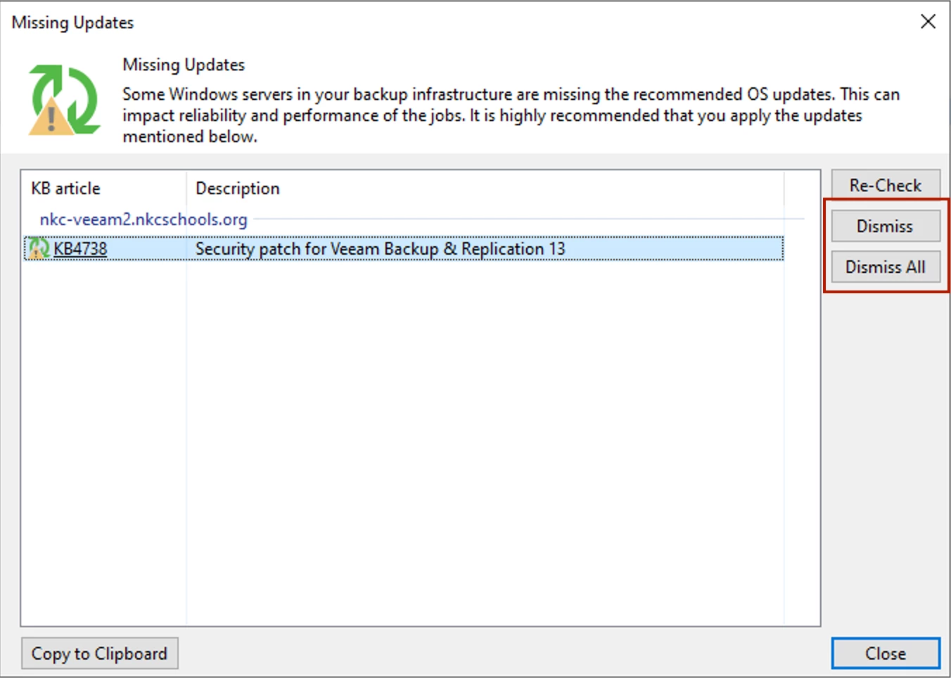

From here, a Missing Updates window will display. Select the Update(s) in the list and you can simply click the Dismiss or Dismiss All buttons. You will no longer get prompted upon logging into the Console about missing updates.
VBR Console Dismiss Updates

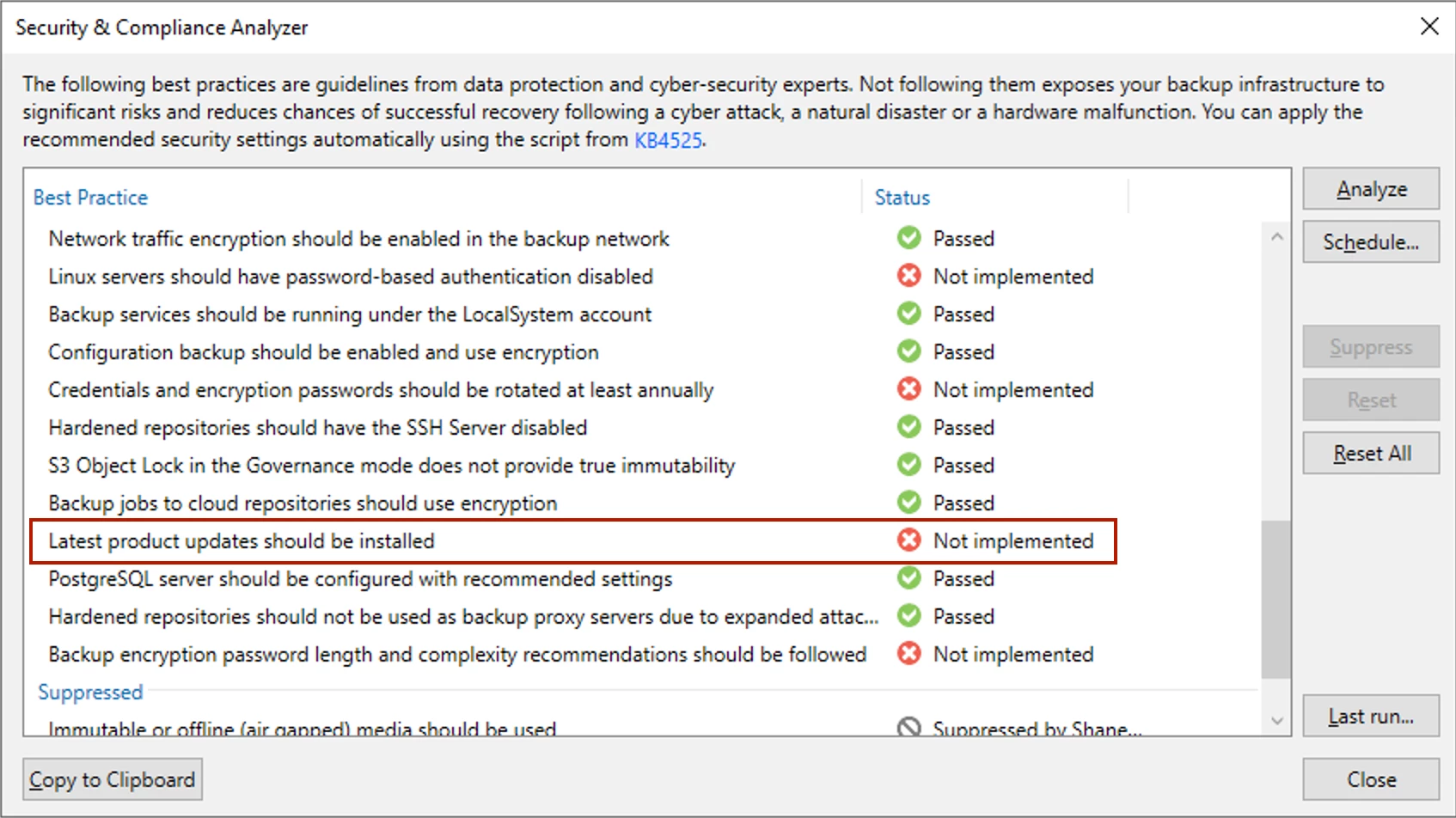

All good, but this is really just a bandaid to an underlying bug. Notice the Description above? As I shared initially, my environment is still on VBR v12, so the listed Description stating “Security patch for Veeam Backup & Replication 13” is a problem. This issue is slightly more than cosmetic sadly. This issue has a cascade effect. How? Well, not only is the VBR Console prompting you to update after logging in each time, the Security & Compliance Analyzer (S&CA) will also show your VBR is not up to date.
S&CA Results

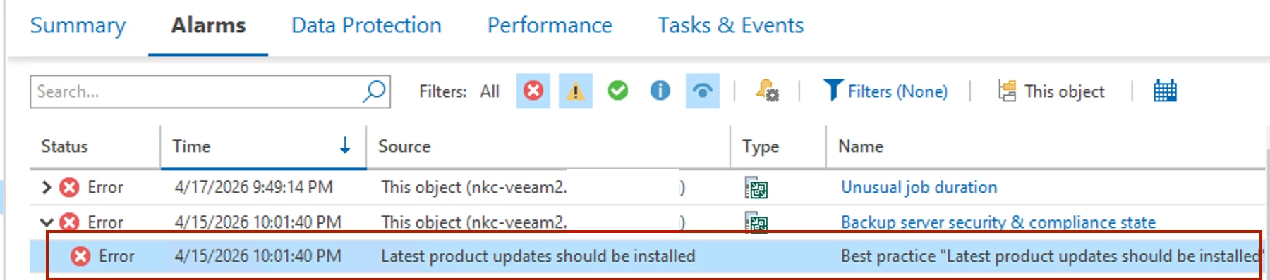

And then from there, when in VeeamONE, you will also get error Alarms for your added VBR Servers that they do not have the latest update installed, because VONE pulls this information from the VBR S&CA:
VONE VBR Update Alarm

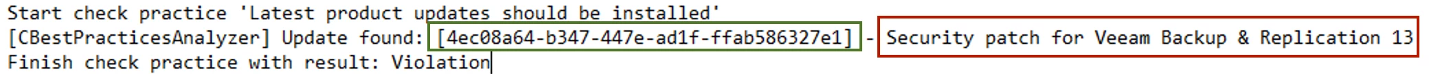

The fix requires retrieving an Update ID from the Job.BestPracticeAnalyzer.log file in the following directory on the VBR Server: C:\ProgramData\Veeam\Backup\<log-file>
Open the log file and from the Edit menu do a “Find” for the following text:
[CBestPracticesAnalyzer] Update found:
What you’re specifically needing is the ID in brackets after the words “update found”. This is needed for the below PSSQL Query command. If you don’t have pgAdmin installed on your VBR Server, do so now as you will need this PSSQL Management Tool to search and modify the Configuration Database. Also note, when I installed this tool, it hung my VBR Servers and I had to reboot them. So do the install during a maintenance window and when no Jobs are running.
