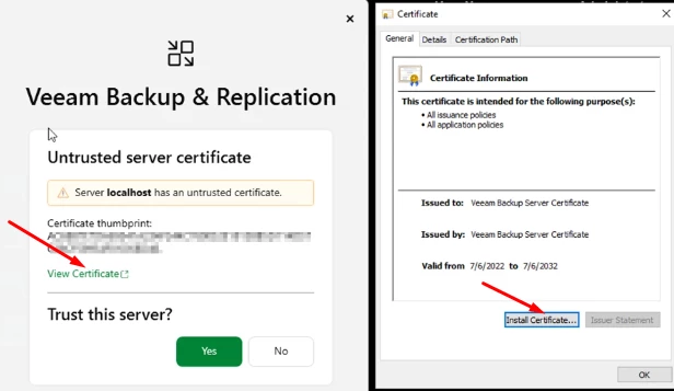

Immediately after the upgrade to VBR v13, the Veeam Backup & Replication console refused to connect to the VBR server.
Instead of the expected login screen, we were greeted with a certificate error. What made troubleshooting especially confusing was that the error occurred regardless of how we tried to connect:

Root Cause: Sophos Web Inspection
After ruling out the usual suspects (certificates, services, DNS, firewall rules), the real cause turned out to be Sophos Web Inspection.
Once web inspection was disabled, the VBR console immediately connected without any issues.
What’s Going On Under the Hood?
With VBR v13, communication between the VBR console and the VBR server seems to rely more heavily on certificate‑based security than in previous versions.
Sophos Web Inspection essentially performs TLS interception (man‑in‑the‑middle inspection) by re‑signing certificates on the fly. While this works for many applications, it appears to break the certificate trust chain used by the VBR console in v13.
As a result:
  • The Veeam console no longer trusts the server certificate
  • Certificate validation fails
  • Connection is blocked, even locally
This explains why switching between hostname, IP, and FQDN made no difference—the inspection layer interfered every time as it exchanged Veeam’s self-signed cert with some random Sophos cert.

Entering the server's FQDN and uploading the certificate also works without disabling Sophos Web Inspection.
Upload where to?
Upload where to?
On the server or workstation where you run the remote console
