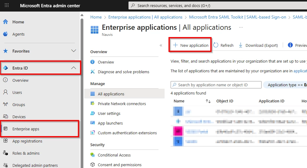

Access Entra ID (https://entra.microsoft.com) and navigate to Enterprise apps and create a new application.

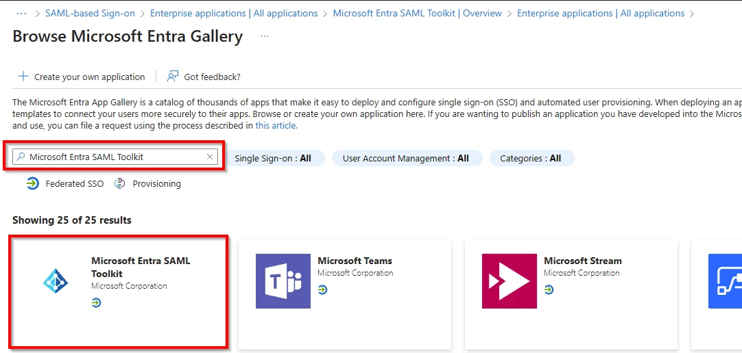

Search in the gallery for "Microsoft Entra SAML Toolkit" and select the app

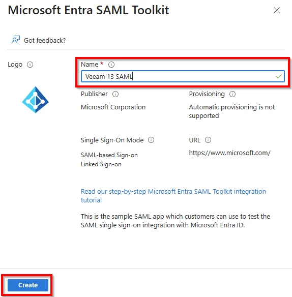

You can specify a name, I choose "Veeam 13 SAML" and then click on create

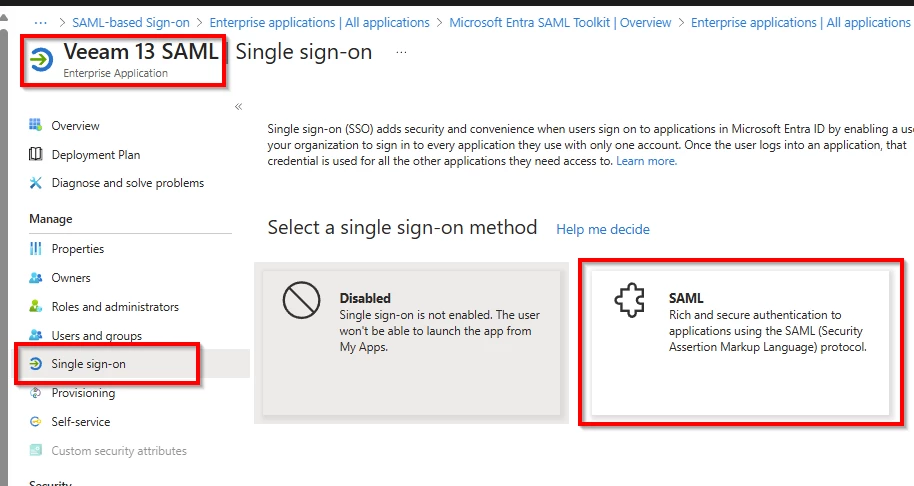

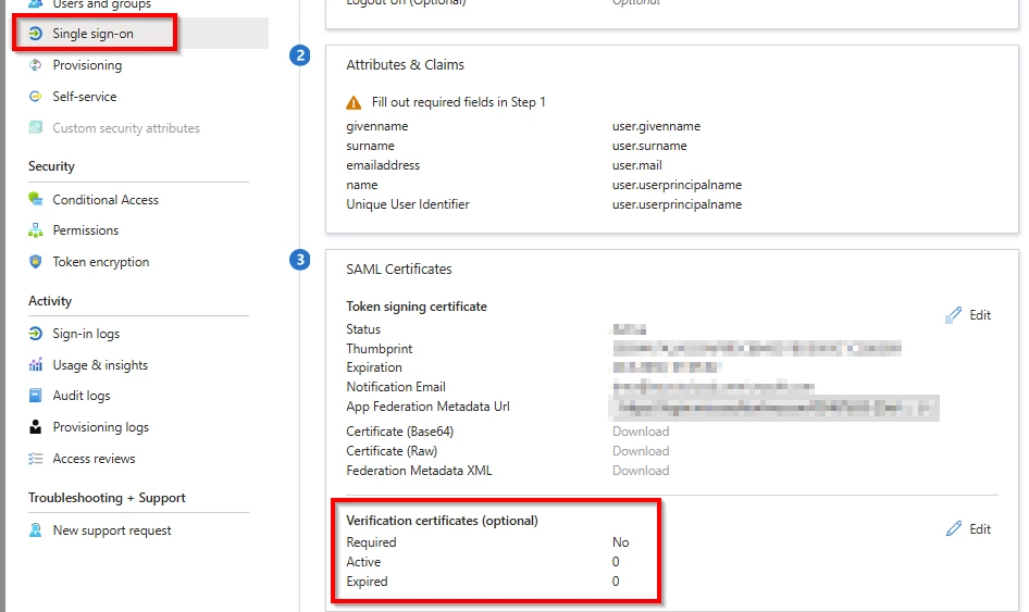

In the newly created application, navigate to Single sign-on and select SAML.

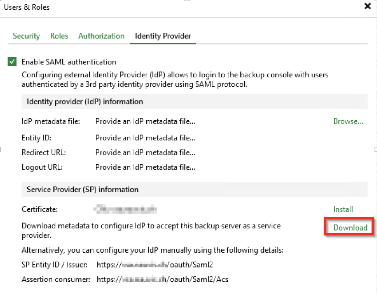

We now need some information from our VBR.

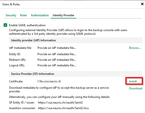

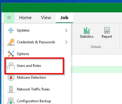

Open "Users and Roles" settings

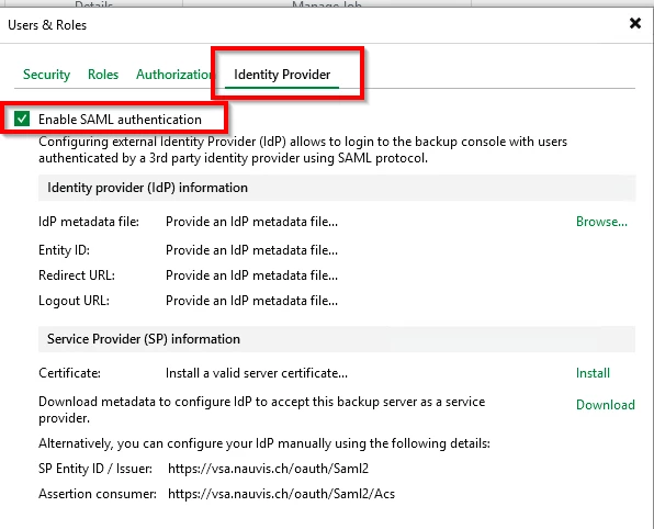

Navigate to "Identity Provider" and enable SAML authentication
First, you have to install a certificate, you can either create a new one or select an existing certificate.
I selected an existing certificate.
I did some testings with different certificates but could not see any difference, maybe this is related to "Verification certificate" on Entra.
But for this to get it to work, we can leave this disabled.

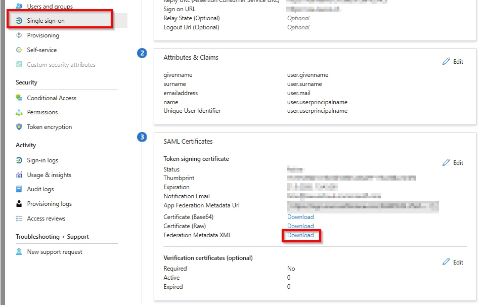

Now we do have the certificate selected and can download the metadata to configure the IDP.

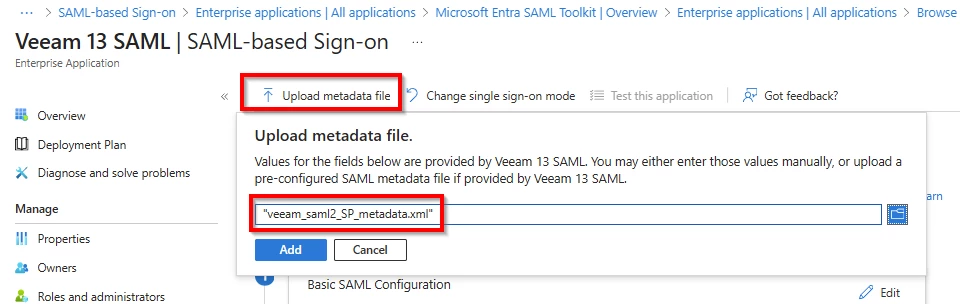

Store this xml file somewhere and then upload it to entra id enterprise application.

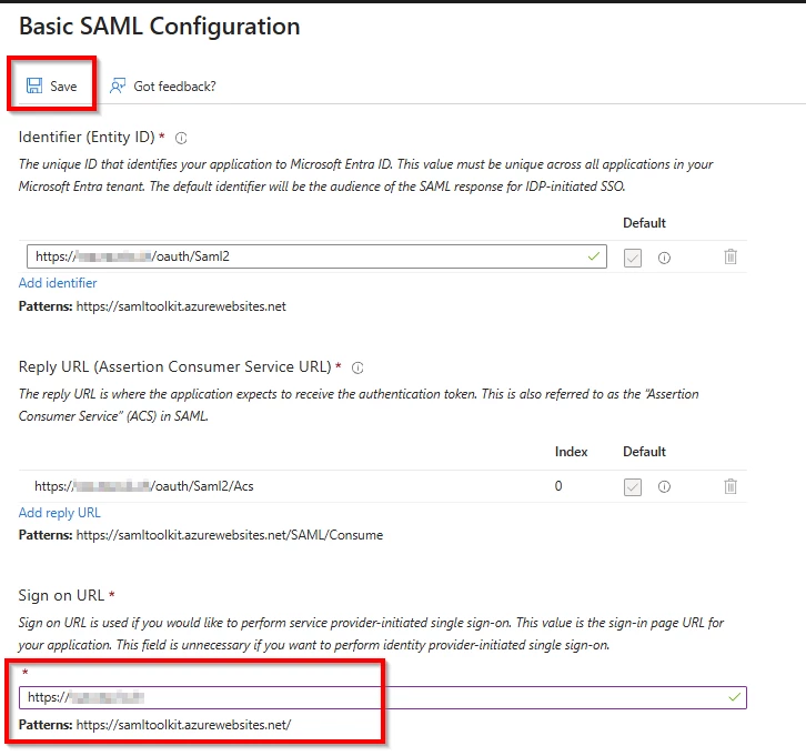

Leve all settings and just add a "Sign on URL" which is just the FQDN of your VBR. Lets say https://vsa.domain.com

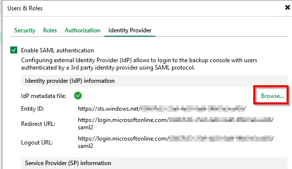

Now we can download the metadata xml from entra id and import it into Veeam.
It should look something like this

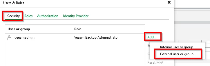

Now we need to add the external user to Veeam.

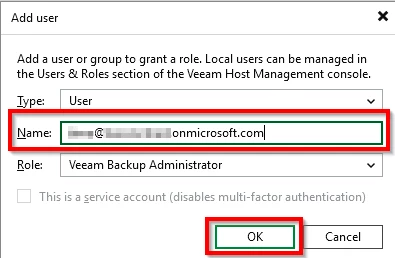

Enter Username or Group name and click OK.

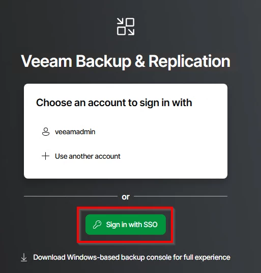

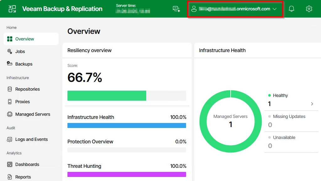

On the login screen on your VBR, you can see a new button "Sign in with SSO"
This will now redirect you to Entra ID login screen. Log in with your user credentials and it will redirect you back to VBR.
