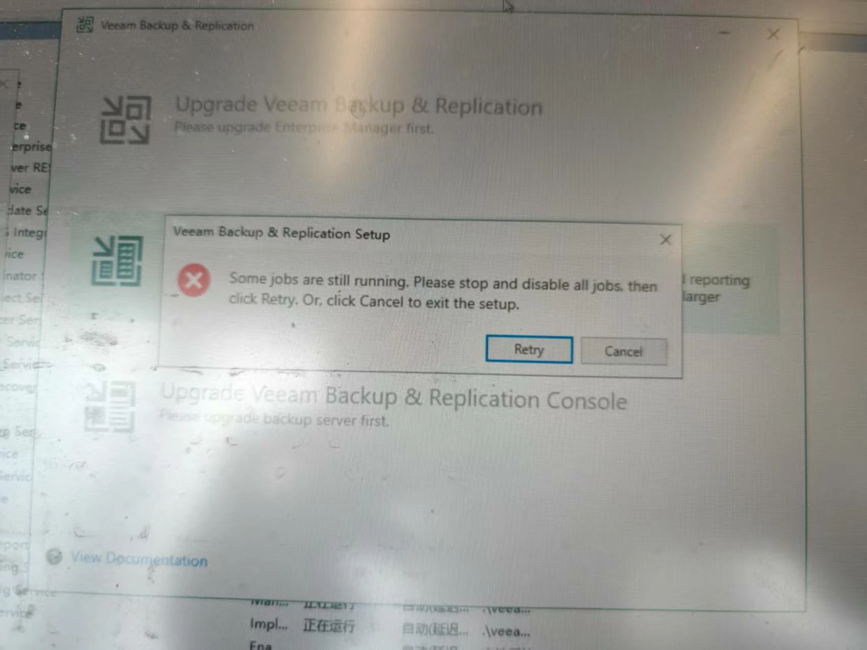

当前的 VBR 版本是 v12.1.156,我需要升级到最新版本的 veeam,即 v12.3.1.113,但它提示备份任务正在运行。我该怎么办?

I usually disable all Jobs before doing an Update. Sometimes its also helpfull to reboot the system after disabling the Jobs.
Regards
Chalid
Stop and disable all jobs. To be sure, close the management console on the VBR server and stop all Veeam related services.
even not directly is some job running, but copy job with immediate copy mode is counted as running job
or jobs with application aware processing as CMF and kristofpoppe mentioned, best practice is to disable all jobs. Another issue is if some user has open console. They have to be closed. Please open task manager and check each user, if they have Veeam process regarding console, if yes, kill it.

You will find more details here as well: https://techdirectarchive.com/2025/03/25/upgrade-vbr-to-12-3-1-setup-detected-inconsistent-configuration/
