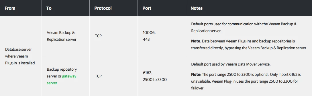

What we expected, based on Veeam’s documentation
Coming from v12, we had the classic data mover range 2500 to 3300 already opened, because it had been mandatory for various data paths in many environments. That led to the natural assumption: worst case it should still work with the known port range and 6162 might be “nice to have”.
This fall-back behavior is even stated in helpcenter as of today:
Of course we checked that before the update and assumed to fine because of what is stated in the documentation. But it turns out not to be correct in that case.

Here e.g. we see a reduction from a whole range of ports (2500-3300) to a single one (6162). Obviously, it was planned to be backwards compatible, still falling back to the old range if 6162 is not available.
Reviewing the logs we determined that this was not implemented like that. After giving it a try with additionally opening 6162 for the connection between the plug in machine and the repository. Then we reran the backup and everything was fine again.

Together with Veeam and with some further tests we could isolate that VBR indeed does fall back to the old port range. It just has a timeout before doing it of ~20min. As we’re talking plugin backup here, the underlying backup application might time out well before - as backint did in our case.
Because of that, Veeam currently has removed the remarks on the fallback to the old port range from helpcenter completely.
