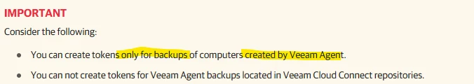

Helpcenter currently falsely states, that the process within PS is only valid for agent backup for bare-metal recoveries.
This is not correct. I found out that it (fortunately😎) also works for enterprise plugins.

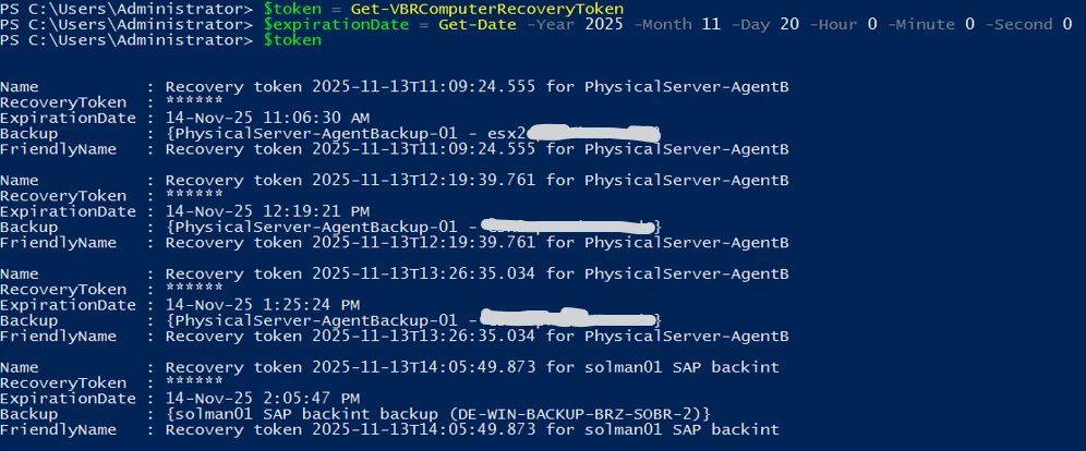

The process to prolong the validity is fairly easy. First, get all currently active tokens and put them into an array (e.g. $token) using “Get-VBRComputerRecoveryToken”. Also, we could directly set an expiration date in the correct format using “Get-Date”. $token will show the full array:

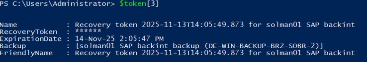

We can see four tokens currently valid. Let’s assume we would like to increase the validity of the SAP-HANA backup of solman01 in the example. This is the fourth item in the list. As it starts with [0], $token[3] will be our token:

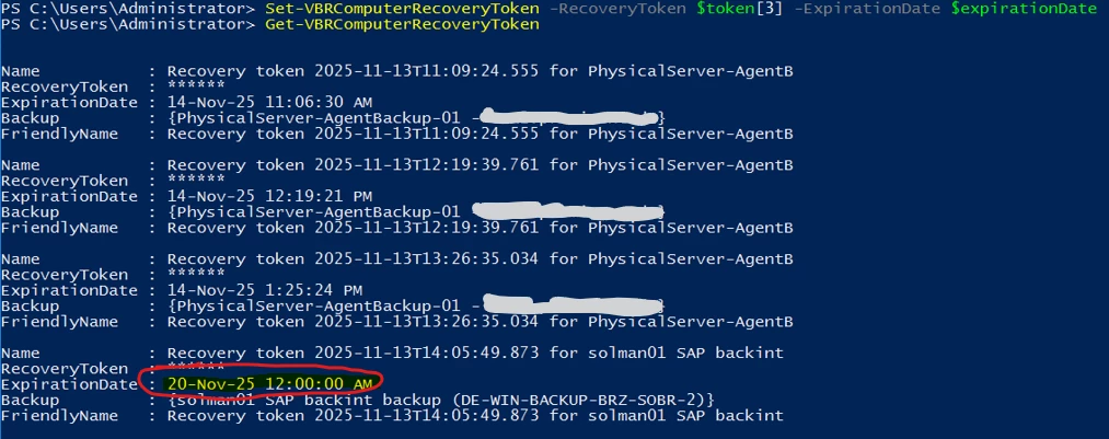

Using “Set-VBRComputerRecoveryToken”, we can now easily set the new timeout for just this element and check the new validity timeout with “Get-VBRComputerRecoveryToken” right away:
Mission accomplished. The timeout is increased.
