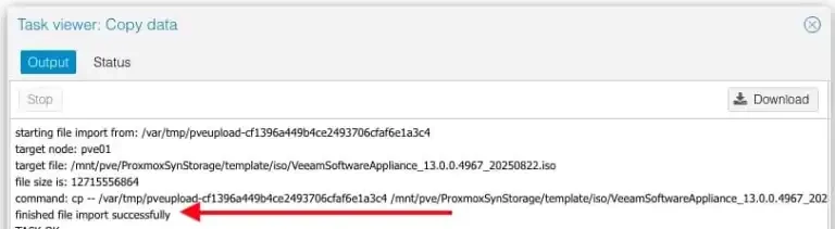

I found the culprit: it had to do with the PVE, and I can attest that the installation was completed successfully. I will discuss this in the blog post.
Dear ​@Iams3le
Can you provide the solution? We stuck on the same error...
Dear ​@Iams3le
Kindly ensure that the ISO is correctly copied to Proxmox storage (local, NFS etc as it is in your case). This time, I waited for the upload status to be complete (ok) and it worked eventually. I am not exactly sure what happened in the first upload. Do not forget to verify the checksum for the ISO before upload!
