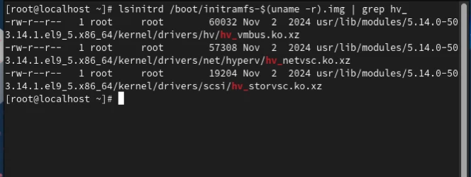

Now let’s verify that the drivers were added successfully.
#Verify Drivers in Initramfs:
lsinitrd /boot/initramfs-$(uname -r).img | grep hv_
This command will return a list of Hyper-V drivers installed in initramfs.img.
