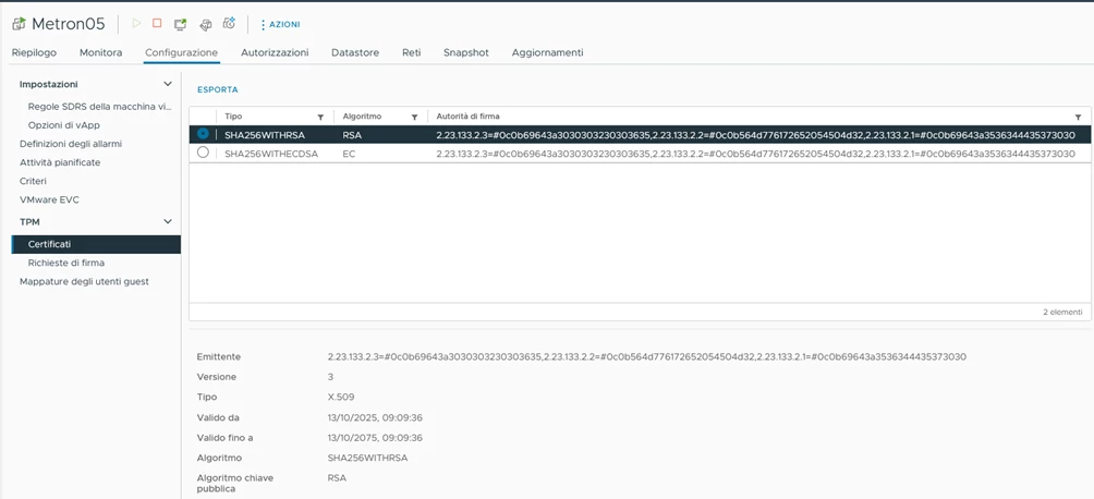

Once the encrypted VM is restored with a different name and/or path, we will see that the VM has a TPM certificate issued by a CA other than the one configured in vSphere, see below in image:

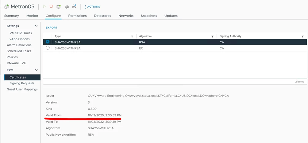

At this point, we log in to the restored VM and run the PowerShell command: clear-tpm
The VM will resume the correct CA:
