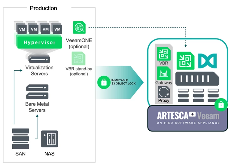

Install the iso on either a physical server or as a VM (for production environment I would recommend a physical server).  This is a Rocky Linux based deployment. The OS will be installed with some defaults. Once this is complete, then the Artesca components are downloaded and installed via a script with some defaults and some customization. The custom pieces are built via an answer script to create a yaml file that is used to deploy the Veeam Windows VM and setup the Artesca node for the S3 storage. You will need to upload a Windows Server install iso to the Artesca system and then can run the installer script that will install Windows Server into a KubeVirt containerized VM. Once this is successful, you then install Veeam Backup and Replication on this server which can be accessed via RDP or VNC through the Artesca node. Here is a picture of the architecture of the install.

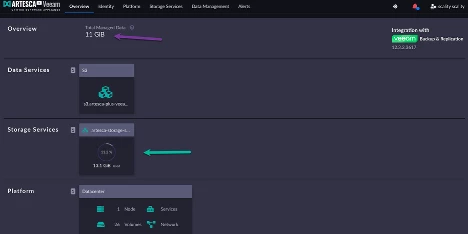

Dashboard view – can see here the total amount of storage that is managed and the total used. You also see the integration with Veeam and the version the Veeam appliance is running. More integration with the dashboard and metrics will be forthcoming.

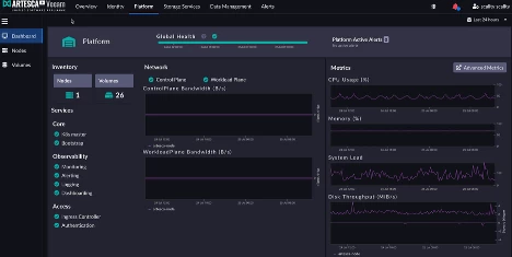

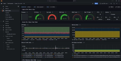

On the platform view, you see the number of Artesca nodes and volumes, network bandwidth, cpu, memory, load, and disk throughput on the dashboard. If you click the Advanced metrics, it will open another tab with a Grafana view

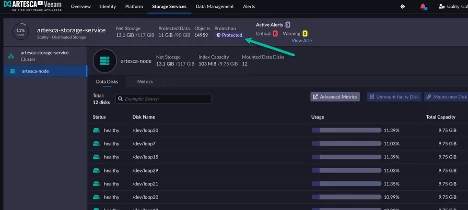

Under Storage Services/node view, it will show your net storage, protected data, number of objects. If you click the Protected under Protection, it will show how many disks can fail before data loss.

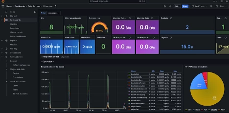

Under Data Management/Data Services – click the Advanced Metrics, opens another Grafana dashboard. This will show the number of objects, buckets, and you can see the S3 API requests.
