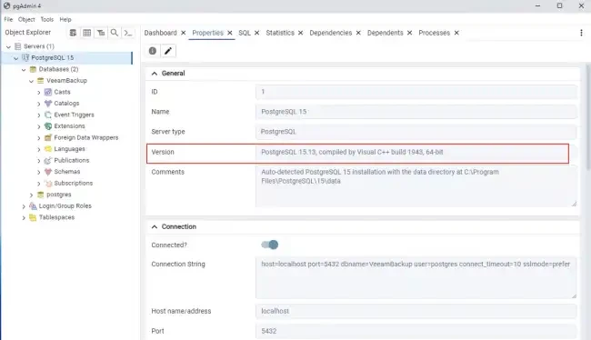

To determine my current PostgreSQL version, please launch pgAdmin as shown below

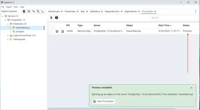

For best practive, I will recommend that you create a backup of the postgresql database backup. To do this, right-click on the Veeam database and select “Backup”.
the backup will start and should end very shortly.

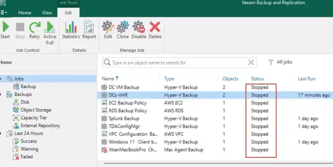

Stop all backup jobs as shown below.

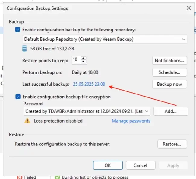

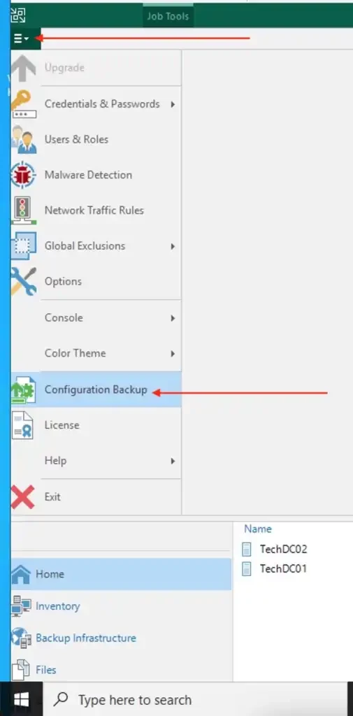

Create a configuration backup. To do this, click on the Hamburger menu and select configuration backup.
Click on backup now. As you can see, the backup is being processed.

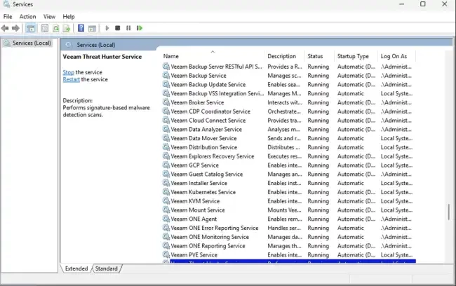

Proceed and stop all Veeam related services
Alternatively, you could use the following command below to stop all veeam related services.
Get-Service Veeam* | Stop-Service -Force

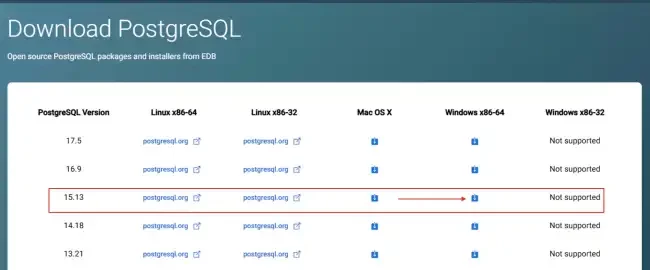

Please, proceed and download the latest version of PostgreSQL. As you can see below, upon clicking on the supported platform to download, the download will start.

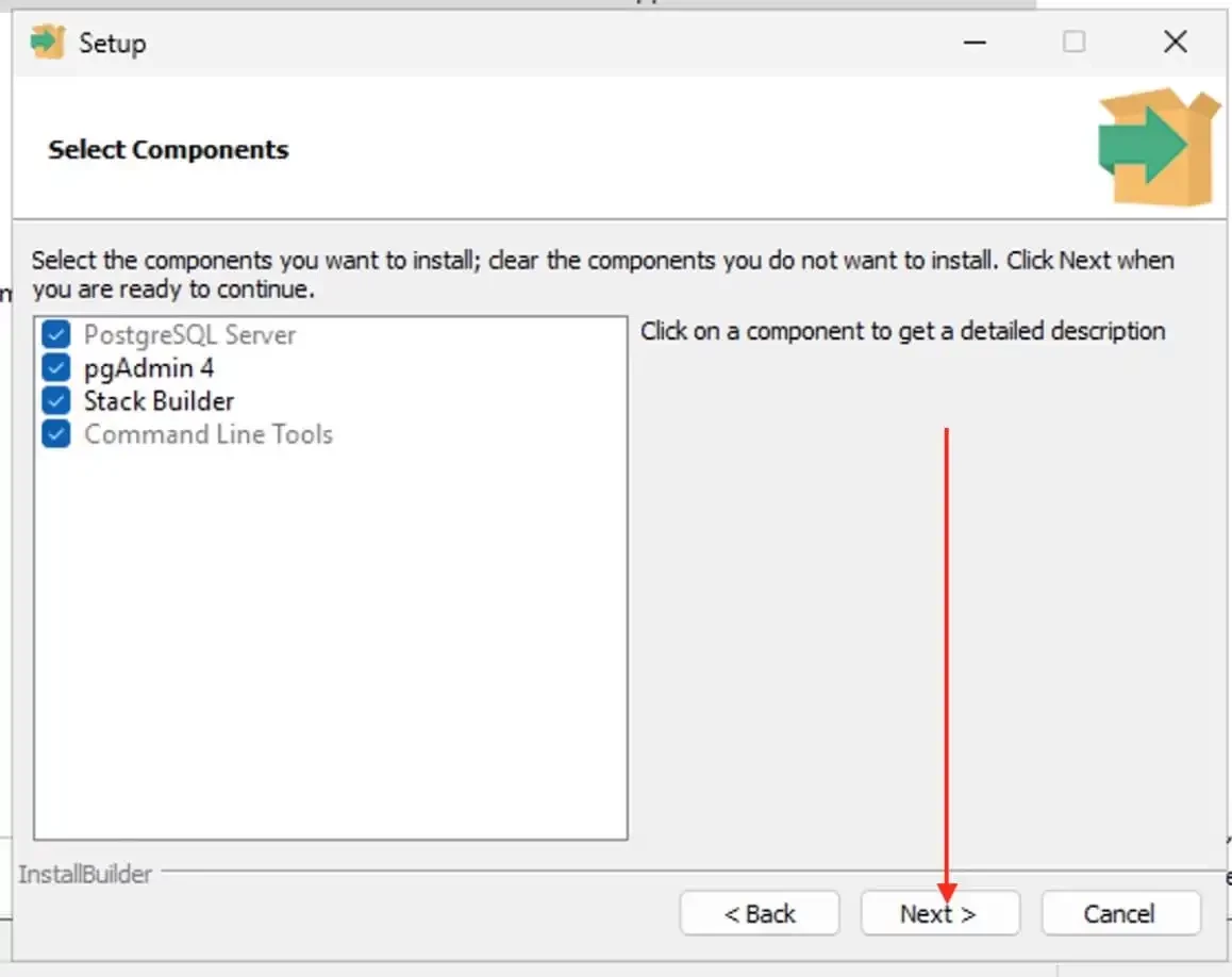

Next, install the new version (same major version). This will replace the binaries, and do not forget to restart the service. Please, see how to “Install PostgreSQL on Windows server as Veeam Database Engine“.
During installation, please keep the same directory data for postgresql. When the installation completes, reboot your Veeam Server and re-enable Veeam jobs.

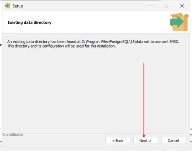

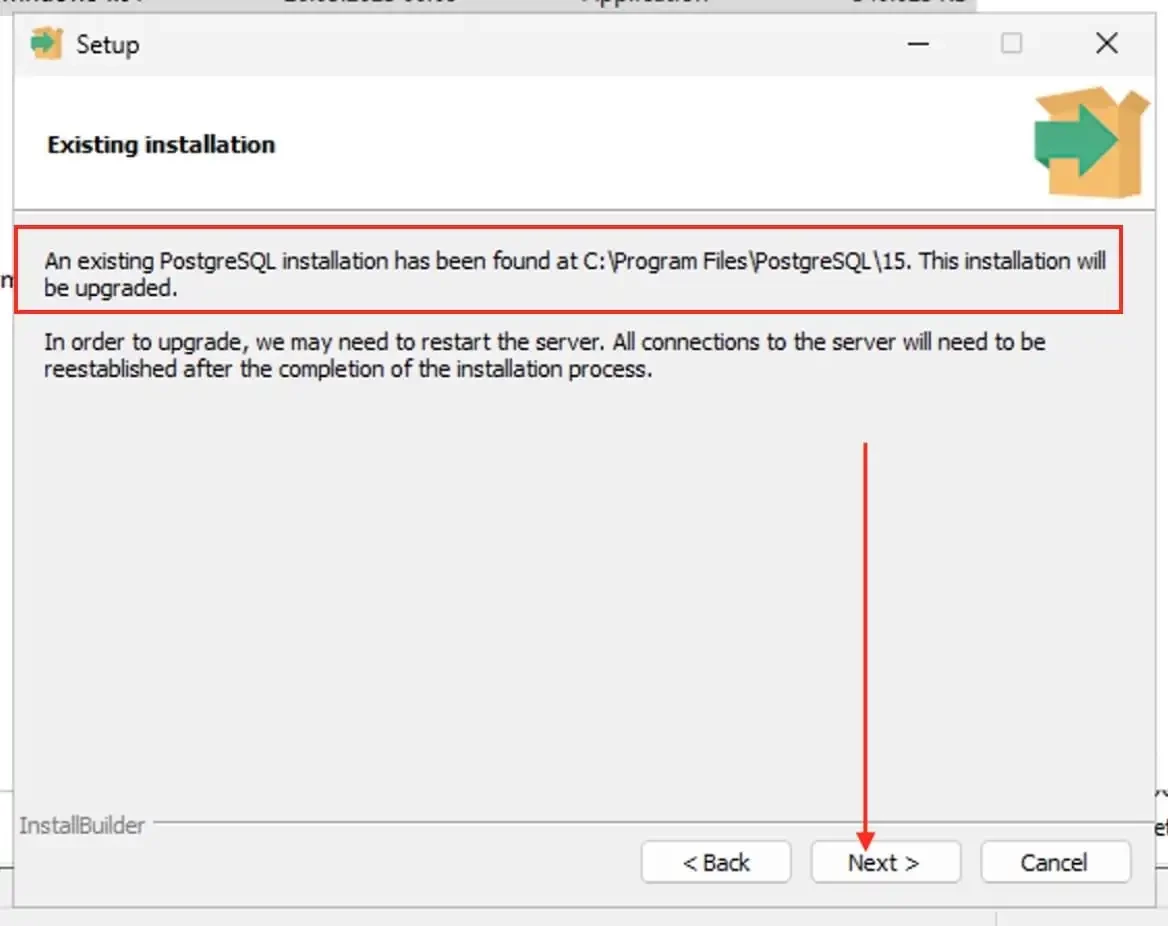

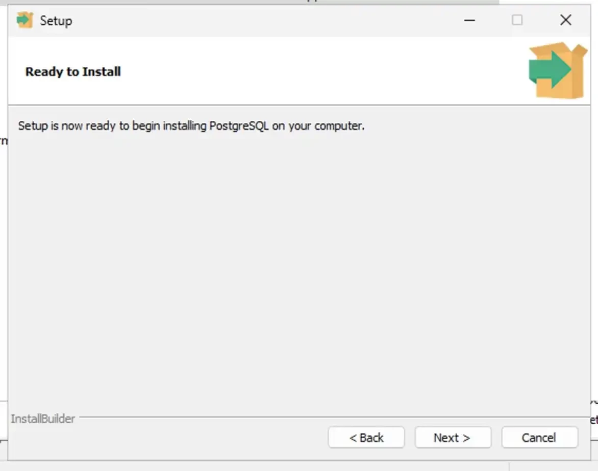

An existing PostgreSQL installation has been found. Please click next to upgrade it
Select Next on the “Existing data directory”

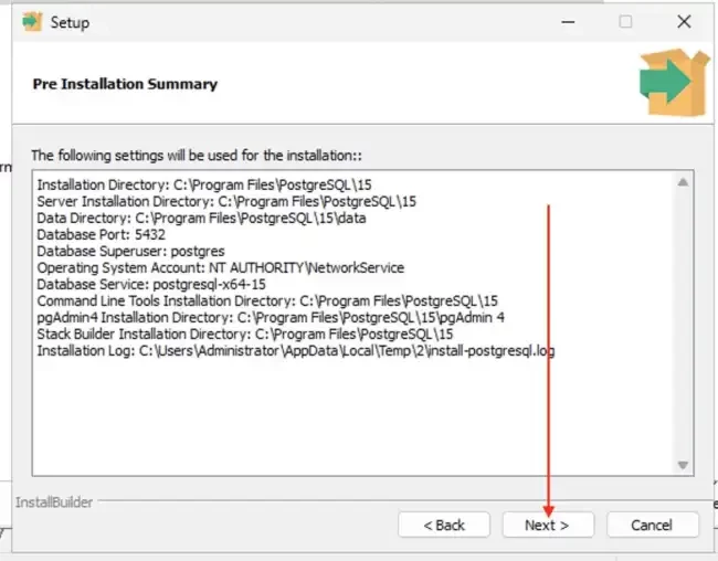

Click the Next button on the Pre-installation Summary window

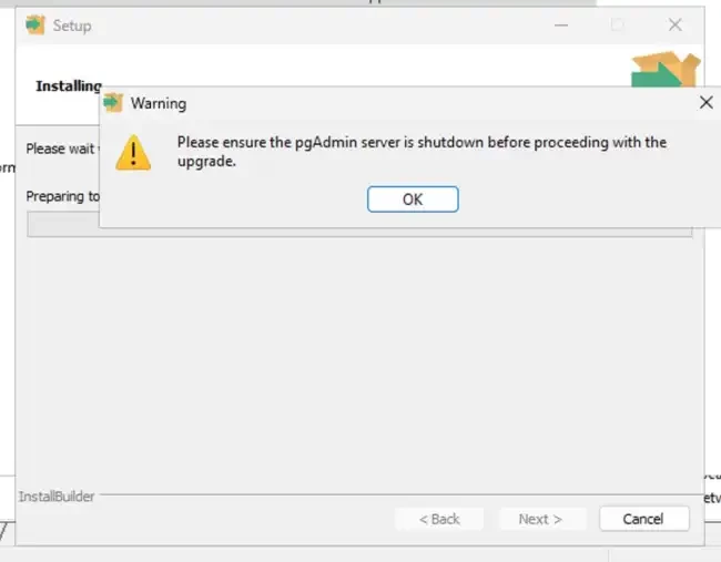

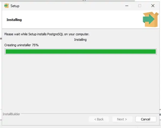

Installation progress

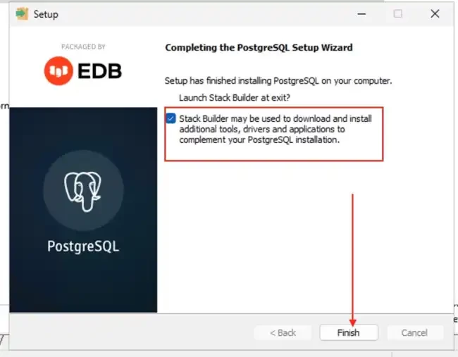

Uncheck the stack builder as you wish

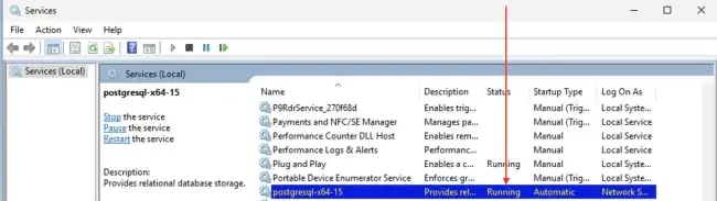

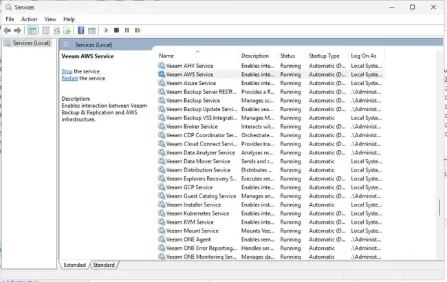

The PostgreSQL service is usually started automatically. I will recommend that you verify this, as shown below by launching the services manager
Launch pgAdmin to determine the version upgrade.

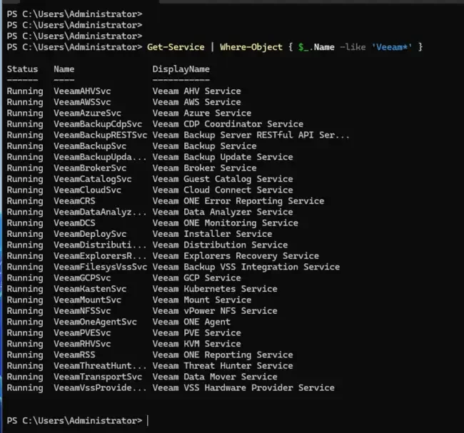

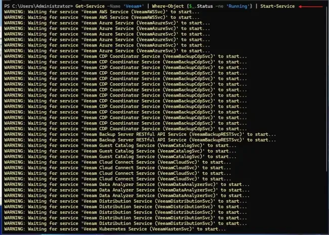

Next, start all Veeam services as shown below
Get-Service -Name 'Veeam*' | Where-Object {$_.Status -ne 'Running'} | Start-Service
All the services are running
