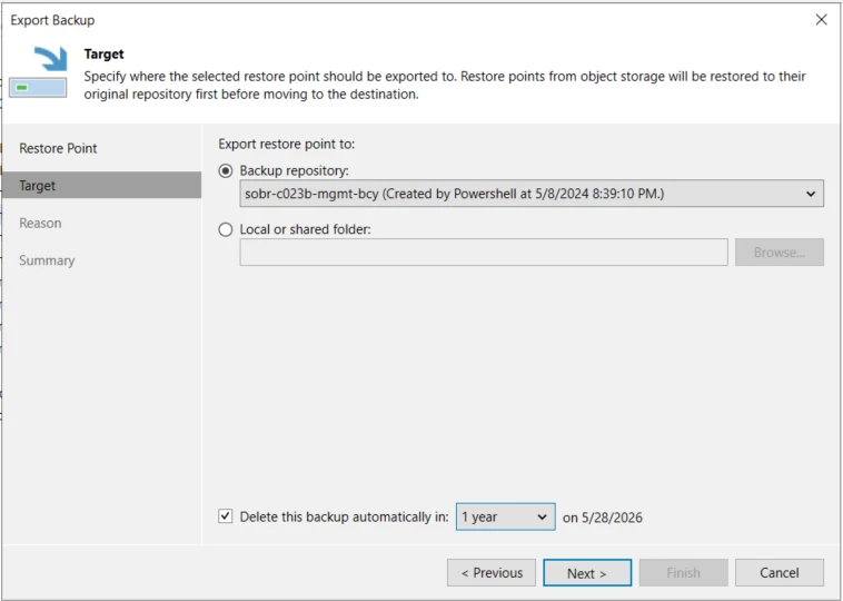

I’m not sure I understand your request correctly, because
  1. If you need to prolong retention for existing chains, just edit the retention settings in the job or copy job - existing backups will follow the new retention setting.
  2. If you need to prolong retention for selected restore points. use the export feature which lets you select target repository and retention. Another option would be to move the existing backups to a new job that has the desired retention setting.
But I guess you’re talking about a use case different from these two?

i was thinking too complicated, (in another product is cmd like bpexpdate, so i was thinking, if something hidden here is not as well)
so, if customer found out, that he needed some restore point of some VM, which does not fit to retention period like 3 months, then only way is to export restore point and set retention like 1 year
but many thanks to all for many hints what are the options!

Yes, this will create the extra RP and keep it for 1 year.
If, instead, you want to have all future backups from this particular vm to be kept for longer as well, simply move this vm to another (new?) job which has been configured with the desired retention settings.
Thanks for clarifying the need -- yes, this is the way to handle it currently with Veeam.
If you’re targeting Hardened Repositories, we have a cmdlet to set a custom immutability period on it:
https://helpcenter.veeam.com/docs/backup/powershell/set-vbrimmutabilitylockexpirationdate.html?ver=120
This works per restore point, but I think it will work on individual ones as well. However, I don’t like this solution as you need to remember to check for the extended immutability -- IMO, Export or Copy backup are the best answer at the moment.
