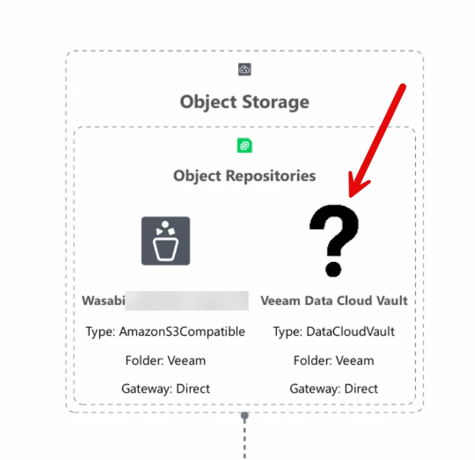

​@jcolonfzenpr - not sure if possible but would be nice if you could input API information to get external S3 Object Storage sizing.  I have both Wasabi and NetApp StorageGrid which I test from my lab, as the NetApp is something we just implemented.
jcolonfzenpr
Could you check if the Backup Console displays usage information for the object storage repos?
I can't retrieve the information from PowerShell using my Wasabi S3 repository…

I'm pretty sure that worked in version 12
Any updates on this?
Chris.Childerhose
Forum|alt.badge.img+23
​@jcolonfzenpr - I just checked the console and the Used Space populates but the Capacity & Free shows N/A for any Object storage repo.
jcolonfzenpr
I believe the usage is calculated based on the total size of all backup files stored in the repository, not from object storage API. Unless this is a bug...

Hi ​@jcolonfzenpr, can you please add an Icon for the Veeam Data Cloud Vault Repository as well in the Diagram?
Thanks and best, Markus
jcolonfzenpr
It has been fixed and will be included in the next release of the report.
Thanks
https://github.com/AsBuiltReport/AsBuiltReport.Veeam.VBR/blob/dev/CHANGELOG.md#102---unreleased
