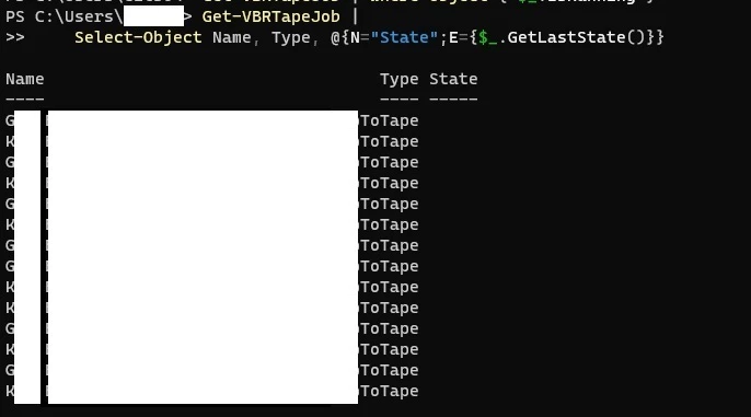

  • Author
  • New Here
  • February 16, 2026
Thank you for your kind reply.
I tried running all the commands you instructed while the tape job was running, but nothing was output.
I'm using Veeam version 12.
I'm new to both Veeam and PowerShell, so I'd like some advice.
W
When I ran the commands without "Where-Object { $_.IsRunning } |", the State field was blank.
Is this related?
Get-VBRTapeJob |
Select-Object Name, Type, @{N="State";E={$_.GetLastState()}}
The white areas indicate the names of tape jobs and my username.
