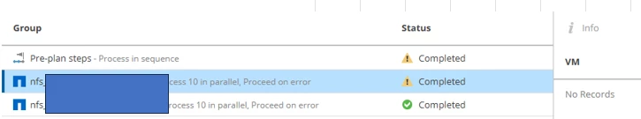

Datastore in Orchestration Plan not showing any VM.
So created a new Orchestration Plan and added the datastores. Found out that a couple of datastores do not show an VM.
The same datastore shows that it has VMs in a different Orchestration Plan. Both plans are pointing to the same datastore thus both should see the VMs. Cloning the new Orchestration Plan does not work and even though how many Data Collection I run, Veeam One restarts, it does not resolve the issue.
What could be causing this issue?
Best answer by spider32
Veeam support gave me the SQL command below to execute. I suggest to backup the VAO DB prior to running the command:
stop the VRO Service
update [veeamaa].[virtualmachines] set sourcemissing = '0' where sourcemissing  = '1'
start VRO Service

Hi ​@spider32, trigger the Data Collection within the embedded VONE instance is also one of the first steps i run, when VRO not show all existing Inventory Items (e.g. VMs).
The steps you did (clone or recreating to another Recovery Plan) is also a good approach.
For another test, you could tag your specific VMs (instead of the Datastore) and check, if you see them (after running an additional Data Collection).
But if this not resolves your issue, i would contact support. But maybe I’m missing something here.
I had a similar behaviour almost a year back at a customer site - only option was to create a Support Case. The issue in that case was in regards to the embedded VONE DB. After some steps with support, we received a SQL query to get rid of this problem.

Yes, I agree. I had to revert back to an older version of the DB to make the Orchestration work again. I still have a ticket open with support (open now for several weeks) but they said they see no issue with the DB side. I informed them that there may some slow corruption going on inside the DB so they are looking at it.
start VRO Service
