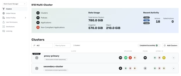

The K10 multi-cluster manager simplifies K10 operations across multiple Kubernetes clusters.
Administrators define primary-secondary relationships between their K10 instances. Primary K10 instances provide a single entrypoint and dashboard for administrators to manage secondary instances. Additionally, Primary K10 instance can distribute the licenses to the secondary instances through license leasing, eventually reducing the overhead to manage licenses in multiple places.
K10 resources, like Policies and Profiles, are defined in the primary instance and distributed to secondary instances. Secondary instances enact their policies and the secondaries' actions and metrics are summarized in the primary instance.
There are multiple ways to bootstrap K10 instances for the multicluster setup, we will be using `k10multicluster` tool to show an example on how to setup multicluster manager with K10.
The k10multicluster tool is used to setup primary cluster as a K10 Multi-Cluster Manager, and to add or remove secondary clusters. Additional information, including how to download the tool, can be found on the Bootstrapping Commands Reference page.
Bootstrap the primary K10 instance
To setup the primary cluster, use the setup-primary command
k10multicluster setup-primary \
    --context=<primary_cluster_context_name> \
    --name=<primary_cluster_name> \
    --ingress=<primary_cluster_ingress>/<k10_endpoint>
Clusters can be given any name, but names must be unique to a cluster and be a valid Kubernetes name. Follow Kubernetes naming conventions while naming clusters.
At this point, the K10 Multi-Cluster Manager has been setup and can be accessed through the primary's K10 dashboard.
Bootstrap the secondary k10 instance
To add a secondary cluster to the K10 Multi-Cluster Manager, use the bootstrap command.
k10multicluster bootstrap \
    --primary-context=<primary_cluster_context_name> \
    --primary-name=<primary_cluster_name> \
    --secondary-context=<secondary_cluster_context_name> \
    --secondary-name=<secondary_cluster_name> \
    --secondary-cluster-ingress=<secondary_cluster_ingress>/<k10_endpoint>
The flag –primary-name must match the name of the primary k10 instance that we bootstrapped in the previous step. Apart for K10multicluster tool, Secondary K10 instances can be bootstrapped from the Primary cluster K10 UI. Below interactive demo shows how to bootstrap the secondary k10 from the UI.
