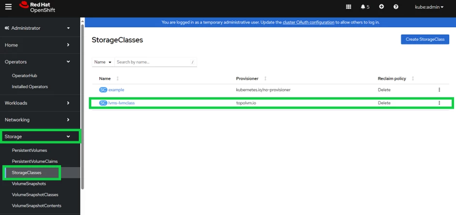

Once Created, we can navigate to storage > Storage class
We can see LVM storage class created
