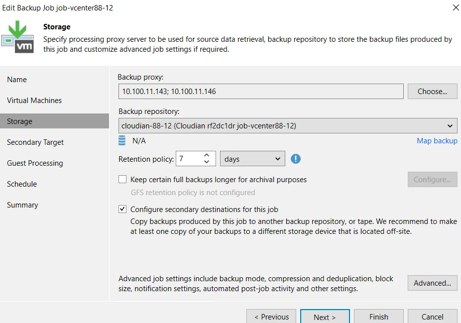

Dear All,
Let me ask for advice regarding the significant difference between the backup size and the repository size, which is causing inefficient storage usage and making it seem like deletions are not working properly. Below is my configuration:
  • Source Backup: vMWare vCenter
  • Destination Repository: Cloudian Object Storage
  • Backup Frequency: Once per day
  • Full Backup: Once per week
  • Rettention: 7 Days

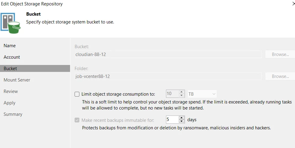

  • Immutability: 5 days + 0 days (I modified the registry to set block generation to 0 days
Capture:
Rettention Policy (Job Configuration)
Immutability (Repository Configuration)
Results:

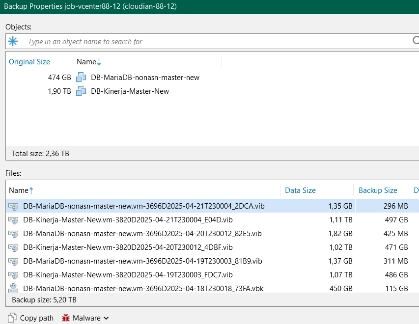

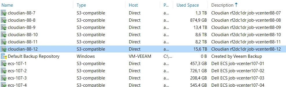

Backup Size 5,20 TB
Repository Size 15,6 TB

  1. Could the deletion be failing because the data is still locked by immutability at the time of the deletion? If so, what would be the correct configuration to avoid this issue?

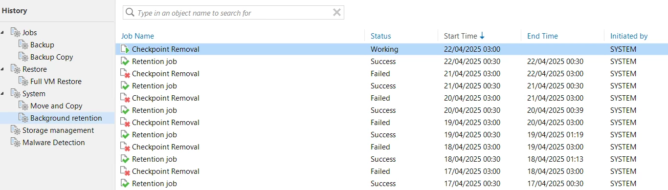

  2. Could it be due to a failed checkpoint removal, as shown below:
Thank you for your attention. I truly appreciate your suggestions and assistance.

Hi ​@epul ,
I saw in another thread that the lowest number. You can Go for is 1 day for Block Generation. Otherwise it will Change back to the Default of 10 days.
Maybe ita worth a try.
https://forums.veeam.com/object-storage-as-backup-target-f52/how-to-reduce-block-generation-days-t87923.html

Cloudian Object Storage is using Casandra database, which very slow and not suitable for using large of  backups or huge amount of backups.
During my PoC, during deletion of blocks, system stuck. There is solution how to be more effective by Veeam in version 13. Problem is that now is used interface of amazon S3, which limited to process amount of objects. In veeam 13, there will be veeam interface, which will fix the issue.
This is not veeam directly problem ….

I recommend aligning retention with immutability revisiting block generation settings and running a repository health check to make sure cleanup is working properly.
You can also run it manually by using Veeam PowerShell.
Start-VBRHealthCheck -Repository "YourRepoName"
