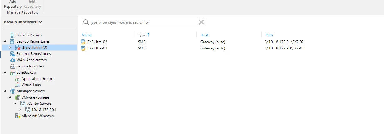

Since upgrading our backup server to Windows 2025, on Veeam the WD devices are showing as unavailable and we are unable to rejoin them to active directory.
This has only happened since upgrading to windows server 2025

Hi what do you mean by WD? My mind keeps thinking WD = Western Digital so some kind of NAS?
Its most likely if a server is showing unavailable you’ve either got a hosts file edit that’s been lost or some other type of network config or firewall rule that’s changed.
Its also possible that upgrading has changed your supported TLS ciphers to prevent communication as they’re no longer compatible.
Please provide more details

It was just a straight up in place upgrade to Windows Server 2025.
I added one of the devices to the hosts file and was then able to ping using host name but after a rescan the device was still showing unavailable.

Hi ​@dannodeg this will be because of SMB changes in WS 2025. Try connecting to the share directly from the same server that is being the gateway to these SMBs, guessing it’s this one. It could be they’re old NAS devices using SMB 1.0, or another auth change.

And this is one of the reasons why I never do in-place upgrades for Veeam. Best practice is to create a new Windows server, export the Veeam configuration backup file, and import it into the new Windows server, choosing the migrate option as described here
Regarding your issue, I noticed that the gateway is set to auto. This means Veeam will use any available windows server to access the SMB share, not necessarily the Veeam server itself. Click on “Microsoft Windows” in the Backup Infrastructure view you’re showing above. Check each of the servers in the list, and make sure it can contact the SMB share from each of the servers listed there. If only some can, or there are some in the list you don’t want to be acting as a gateway, edit the properties of the repository and choose a specific gateway server.
