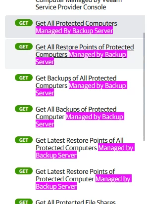

This is the data shown in VSPC → Protected Data → Computers → Managed by Backup Server.
Maybe I’m missing something obvious.
/protectedWorkloads/virtualMachines = on-prem virtual machines (vSphere, Hyper-V, AHV, oVirt, Promox)
/protectedWorkloads/publicCloud/virtualMachines = cloud virtual machines (AWS, Azure, GCP)
/infrastructure/backupAgents = agents managed by console

Endpoint /infrastructure/backupAgents just brings back computers with agents managed by the VSPC itself. Or at least it does for me, ie. I see the same list as the VSPC provides in Protected Data → Computers → Managed by Console.
I want the information in Protected Data → Computers → Managed by Backup Server.
Forum|alt.badge.img+3
  • Experienced User
  • October 10, 2025
Got it, thanks for clarifying -- I’m not expert on VSPC API as I don’t work with VSPC much, but I think the endpoint you need is further down:
https://helpcenter.veeam.com/docs/vac/rest/reference/vspc-rest.html?ver=9#tag/Protected-Workloads/operation/GetProtectedComputersManagedByBackupServer
Looks like there’s a separate set of endpoints for ‘Managed by Backup Server’

Sweet, how did I miss that!
