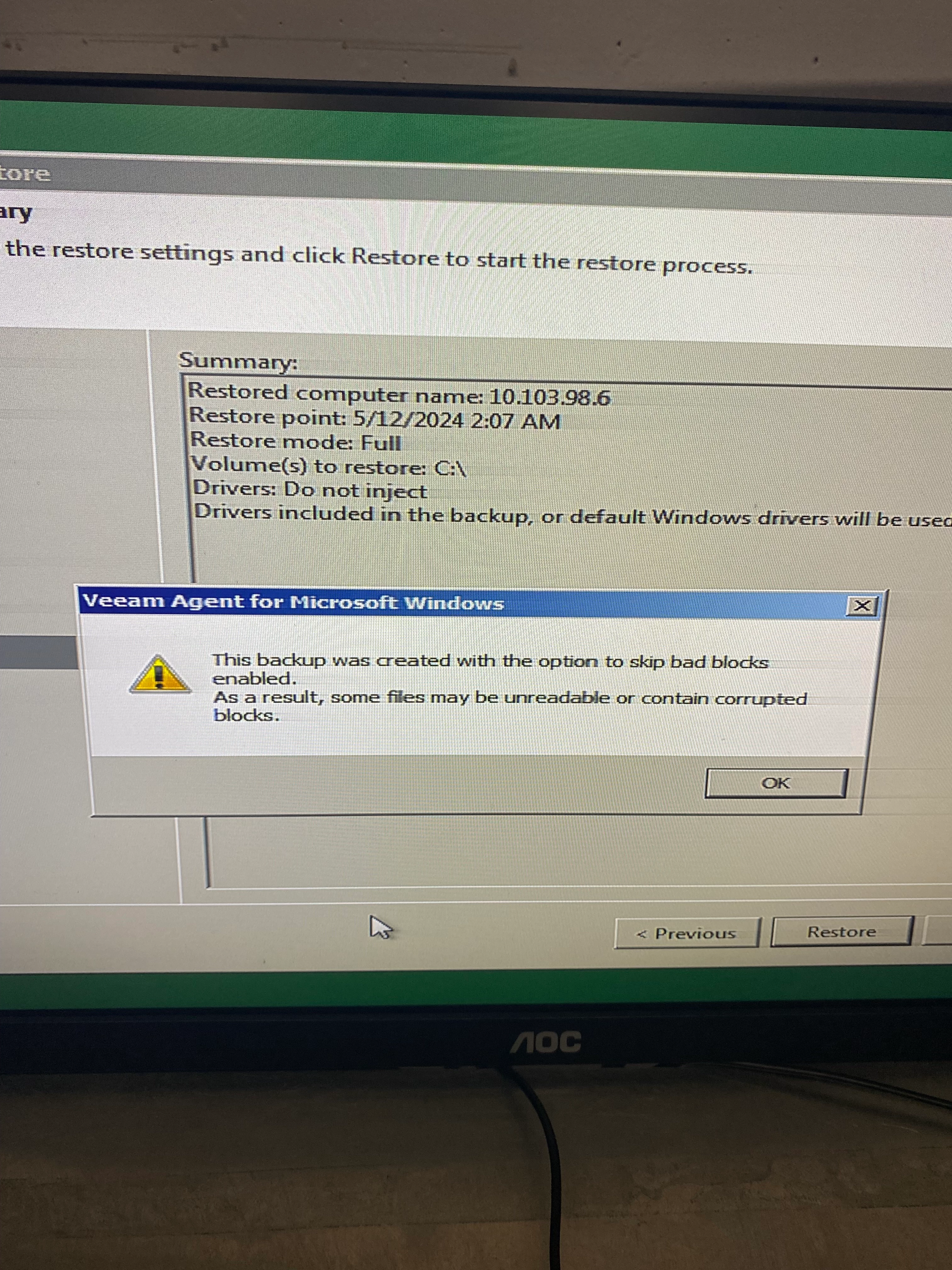

We tried to  restore ( entire computer ) one of our production computer due to slowness.
we tried multiple full backups from different dates. But all restored Hard disk ( New ) having some booting issue.
  1. Automatically go to automatic repair mode and failed
  2. Cant boot into safe mode
  3. Went through the startup chkdsk - failed
** Noticed a warning as shown on the image during restore process . does it related to this booting issue ?

Hi
Thank you very much for your valuable guidance. we tried multiple backups from Veeam repository, but all had same booting issue.
Then I took an HDD duplication/Clone from original slow HDD to a NEW HDD. and ran sfc /scannow and chkdsk command. it is working ok now and much faster.
*** And It is Windows 7 Professional SP 1.
look like the above veeam warning (image attached) related to the booting issue of all restored new HDDs.
not sure when backing up it skip any important system files as bad blocks.
Thanks Again

Hi Guys,
Should we disable the above mentioned “bad block skipping feature “on Veeam to avoid these kinds of problems?
I feel like, because of this skip bad blocks enabled option, all of our Veeam repository backups have system-level file corruption or file missing issues. That is why all the backups we tried did not work, even after we attempted to fix them.
Thanks

Hi Guys,
Thanks
Yes you should and also turn on health checks in Veeam to validate backups.
Hi Chris.
These are the information I found when I checked the Veeam agent on the PC.
  1. look like only last 4 backups) had bad block issue. all backups before that, are ok (Green) .
  2. And I push a manual backup and it went ok successfully.
I am bit confused now, if this is related to system file corruption or veeam agent settings.
****image attached ----
Thanks guys, for expert advice.
Chris.Childerhose
Forum|alt.badge.img+23
It looks like it is HDD bad blocks so it skipped those in the backup based on your screenshots.  So you need to always check the backups to ensure there are no bad blocks for restores.
