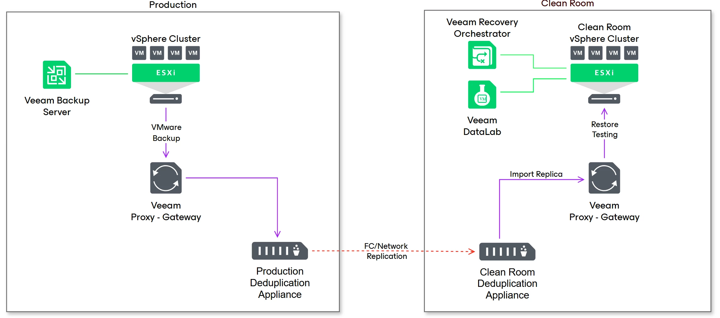

I’m working on an architecture to implement VRO with a Clean Room.
I ll be in this kind of topology :

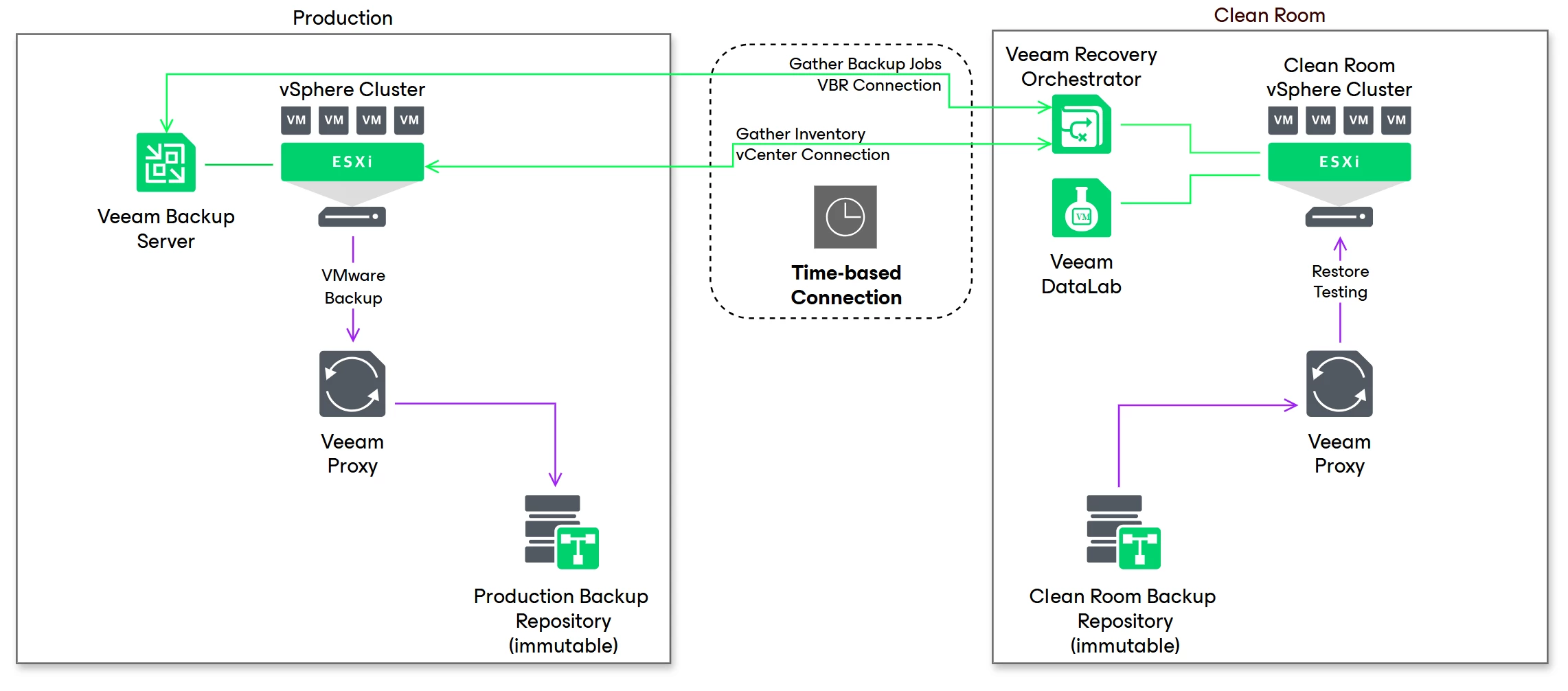

I notice in the prerequisites, this point :
“The current release of Veeam Recovery Orchestrator (v 13.0.1) requires at minimum an initial connection to the production vCenter to gather inventory and create restore plans using vSphere tags.
Connection to the production VBR is optional and only required to create restore plans based on backup jobs.”
The principle of a clean room is to have an environment that is completely decoupled from production, acting as a safe place to store and test backups, and as a trusted source for a clean recovery of workloads, even if the production environments are infected or compromised.
Opening network flows to production, even temporarily, seems to go against that principle in my opinion, even if those flows are limited. In my architecture, I have a production vCenter and most likely a dedicated vCenter for the clean room, since standalone ESXi hosts cannot be targeted/managed directly.
I’d be interested to hear your thoughts on this prerequisite.

One question I would have is if this is a requirement once the connection is made and done doing what it needs can you remove it?  I get your point about clean room for sure.
VRO uses vSphere Tags for jobs and recovery locations. Tagging infrastructure components is necessary to create a Recovery Location and let VRO restore to an alternative site. It also lets the administrator set up a pool of resources that VRO can use to recover workloads.
Tagging VMs allows the Orchestrator to bypass the connection to the production Veeam Backup & Replication server, and use exclusively the embedded VBR for recovery.
By using Restore Plans and VM tagging, the only required connection is to the vCenter. This connection does not need to be maintained continously: it is only needed when new VMs are added or removed and a rescan must be performed.
Well… if you have a lot of modifications in your vSphere infrastructure you have to open the link ofen.
