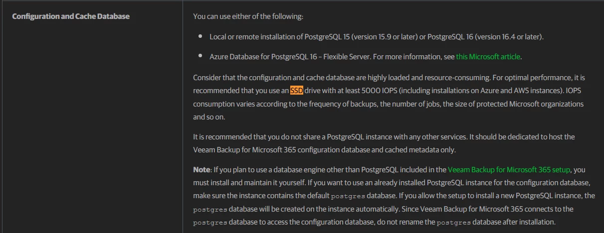

Update. The local Server where Backup for 365 is installed has an SSD disk (backup repository) which is maxing out when processing the jobs.
Trying a new disk to see if the issue continues...
Veeam recommends hosting the PostgreSQL database on SSD storage with at least 5,000 IOPS to ensure adequate performance and to prevent the database from becoming a bottleneck during backup, restore, and search operations. This is a performance recommendation rather than a strict minimum requirement, especially for larger Microsoft 365 backup environments.
System Requirements - Veeam Backup for Microsoft 365 User Guide
