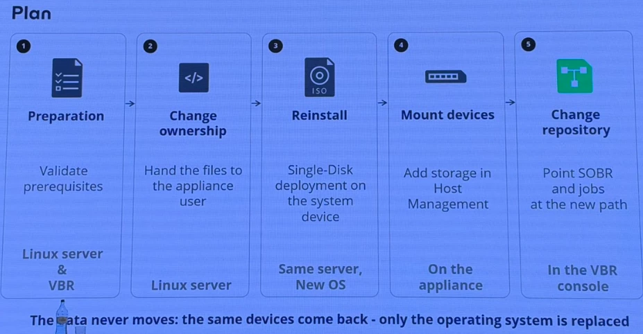

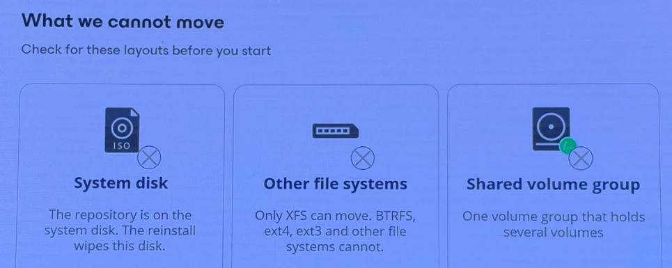

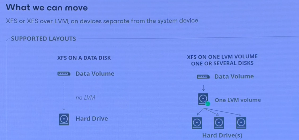

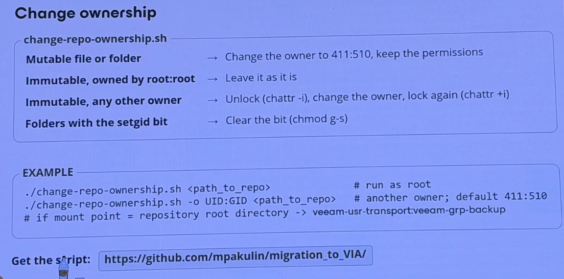

...we just had a session about exactly this topic (in this case from Ubuntu to the VIA)
It’s not an official migration path and should be tested in a lab first. A script to change user/permission on the XFS Repo was also used.
Currently the script isn’t public available, but it will be asap ;-)
